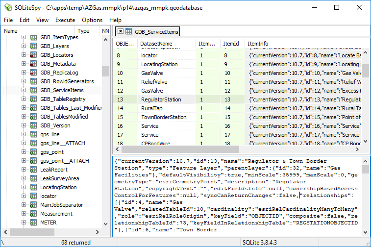

Let's take a look at how relationships are stored in a mobile map package. In my previous article, I introduced you to the GDB_ServiceItems table. The ItemInfo field in that table stores the JSON data used to hydrate the ArcGISFeatureLayerInfo class:
Here's the JSON that describes the RegulatorStation to GasValve relationship from the origin role:
"id": 4,
"name": "Gas Valve",
"relatedTableId": 10,
"cardinality": "esriRelCardinalityManyToMany",
"role": "esriRelRoleOrigin",
"keyField": "OBJECTID",
"composite": false,
"relationshipTableId": 73,
"keyFieldInRelationshipTable": "REGSTATIONOBJECTID"
And here's the description for destination role:
"id": 4,
"name": "Regulator Station",
"relatedTableId": 13,
"role": "esriRelRoleDestination",
"composite": false,
"keyFieldInRelationshipTable": "GASVALVEOBJECTID"

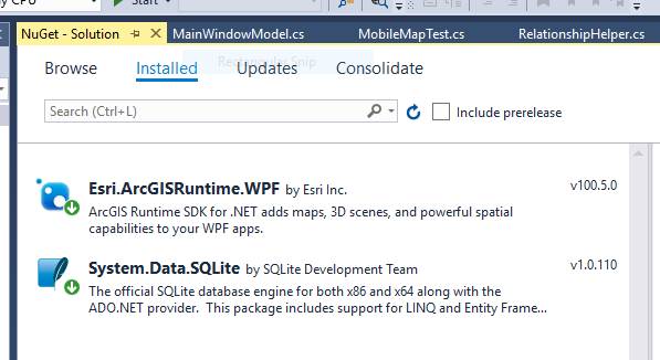

The two crucial items that are not included in the RelationshipInfo class are relationshipTableId and keyFieldInRelationshipTable. But how to get at that information in your app? Aye, there's the rub. In short, you need to extract the geodatabase from the mobile map package and query the GDB_ServiceItems table directly. That's where you need a library such as System.Data.SQLite, which is available via the NuGet Package Manager:
