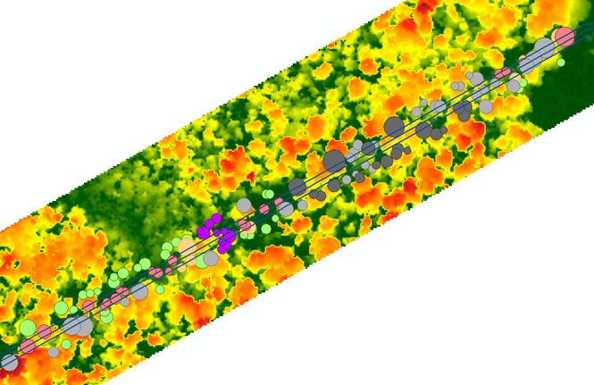

First of all you will need to create a Canopy Height Model (CHM) or normalized Digital Surface Model (nDSM). This is obtained by subtracting the terrain from the surface (CHM = DSM – DTM). Each cell will indicate the height of objects.

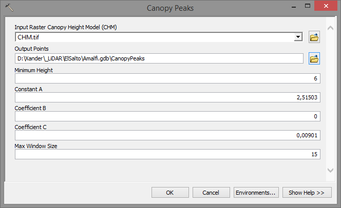

The Canopy Peaks tool create a set of points that represent the tree locations and will contain information of the height of the tree:
I have had better results using using a TIFF as Canopy Height Model raster. Play around with the Minimum Height and Max Window Size to get the best result.

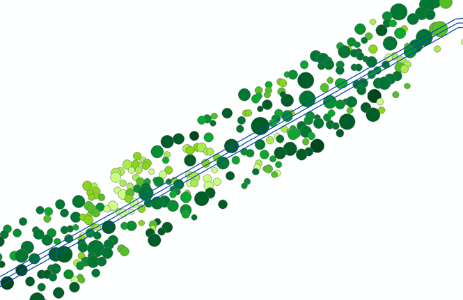

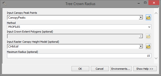

The resulting point featureclass will have information on the height of the tree. The only thing missing variable is the size of the crown. This data can be obtained with the tool “Tree Crown Radius”.
The result of this tool is the creation of an additional field “CrownRadius” with the information we search for.
You can visualize the points using the crown radius to evaluate the result and perhaps apply some filtering to filter out false positives.
Using the python code to create 3D trees we can proceed with determining the 3D distance to the overhead power lines and classify detect those trees that need to be logged according to the various criteria that apply:

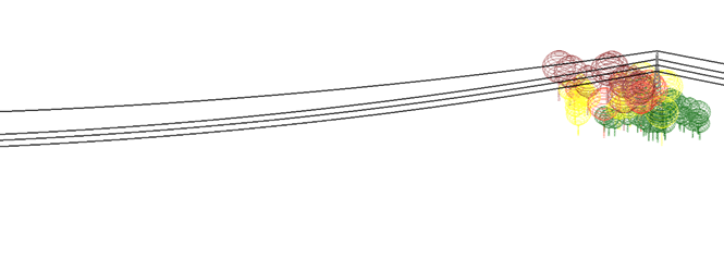

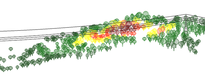

Since we have both the partial inventory and the LiDAR data for the same area we can compare both results:
Result of the 3D analysis using the partial inventory and maximum potential size of the trees
Same area but now with the trees based on the LiDAR data and current size of the trees
