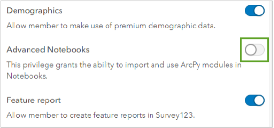

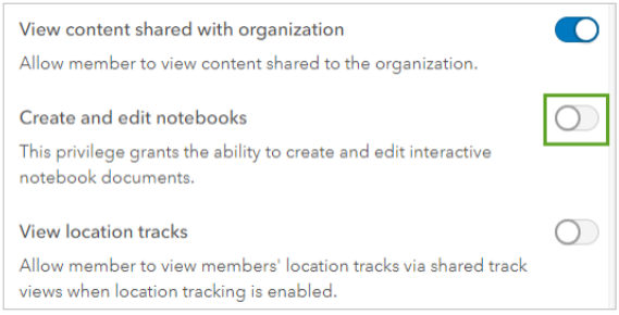

Q: Is a custom role needed to enable ArcGIS Notebooks access? How do I enable access to ArcGIS Notebooks for all the members in ArcGIS Online?
A: Notebook privileges are assigned through the role settings. To assign privileges that allow users to access standard or advanced notebooks in ArcGIS Notebooks, you’ll need to create a custom role in your ArcGIS Online Settings (by Administrator). You can create the custom role based on any of the default roles such as Publisher role. Once a new custom role is created, you will need to add notebook create and user privileges to your new custom role:
- Under Role privileges, expand the Content group and turn on Create and edit notebooks. This allows the user to create and edit standard notebooks.
- Expand the Premium content group and turn on Advanced Notebooks. This allows the user to create Advanced Notebooks that use ArcPy or access the GPU-enabled notebook runtime.
Once you’ve created a custom role with Advanced Notebooks enabled, you can make that role the default role for new users (Settings > New member defaults). All users joining the organization from this point forward will automatically have access to ArcGIS Notebooks. You will also need to assign that custom role to the existing members.

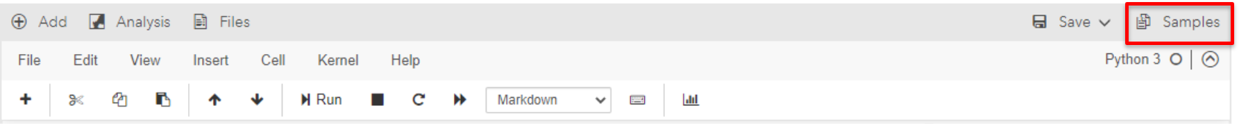

Q: Are there some samples Notebooks? Where can I find them?
A: Samples are included in ArcGIS Notebooks. There is a link to the Samples on the top right of your Notebooks in ArcGIS Online.
There are sample notebooks for categories: data science and analysis, content management and ArcGIS Online administration.
