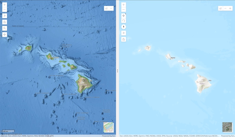

"WHOA! COOL!" is by far the most common phrase uttered when people do one simple step with a simple webapp I created for demos. Adults or students; I've tested as young as age 8. See this "comparison" app, which starts in Hawaii. When the app opens, look in the top left corner of the left map and click the "-" button 3 or 4 times: Open this example app: http://arcg.is/hawaiicompare.

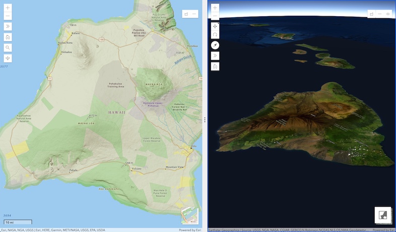

Comparison is a time-tested powertool for learning. Seeing two different presentations of the same location at one time is huge for proving that there is always more than one way to think about any given scenario, and nothing demonstrates at once more powerfully and simply this fundamental capacity of GIS. The left map is a 2D view (Web Mercator projection, standard these days, for better or worse), and the right is a "3D" scene (on a flat screen, starting in "overhead" view). The displays are synchronized, to the degree possible; both can pan, zoom, and rotate, but the right map (being a scene) can also "tilt." Both can swap the basemap with one in the lower right corner, expanding comparisons. This duo uses only basemaps and default tools. It took about ten minutes to set the basics, and another ten to test/tweak/save/repeat. The template can mix or match content types and locations, but coupling a 2D map and a 3D scene generated the desired impact.

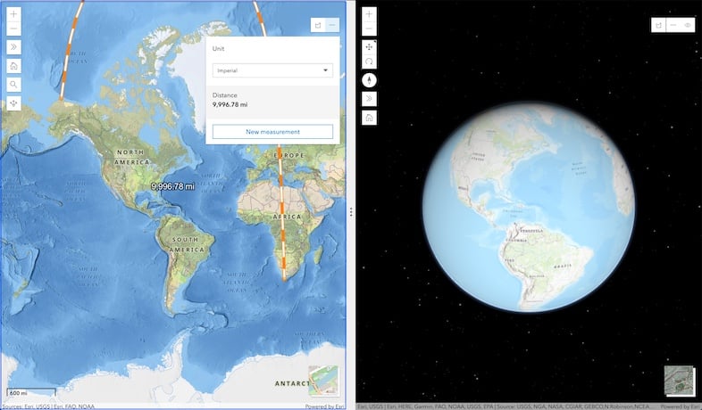

The example above was done using a public account, with no special data or tools. Notice that, using the 2D measure tool, you can see that flying the shortest distance from the northernmost tip of Alaska to the southernmost tip of Africa would involve flying almost due north over the North Pole; you can, of course, confirm it using the line tool in the 3D display. For another situation, I did a similar 2D/3D comparison app using my Organization login, and focused on a single local watershed, showing a downstream trace from a special location and the upstream watershed, so users could tip and rotate and grasp the environment. Careful planning of layers in the map and scene can yield huge impact. Embedding the app in a StoryMap lets the creator provide a little context or instruction (for use in or away from class), and lets the user launch out into full screen.
