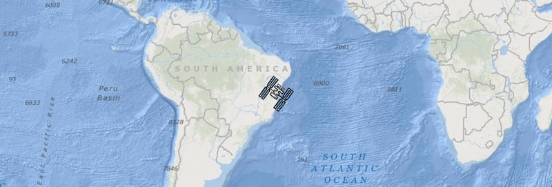

It's that easy! Now you have a map that shows the live current location of the ISS.

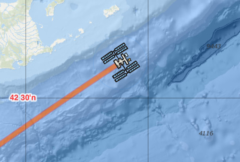

Of course, it's a little counter-intuitive to see the blue dot tracking the space station (we've been trained to associate it with our own location), so we use some of the AGSLocationDisplay configuration options to change the symbol to use an icon of the ISS. Find the entire Xcode project here.

There's also a slightly more detailed version with an overview map, reference lat/lon grids, and a path-tracking geometry here.
