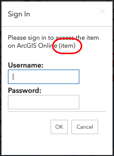

If you created the layer using the url property, the modal login dialog will look like this:
Not very useful.

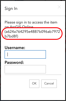

But, if you created the layer using the portalItem property, the modal login dialog will look like this:
Very useful.
The dialog tells you right there exactly which Portal Item it is trying to open. You can go back into your code or your Content tab and find the layer that may not have its sharing permissions set as you expected. Or perhaps it's an item owned by some other person or organization. Or maybe the content used to exist, and doesn't any longer, and maybe then you can find the source data and rehost it yourself, then change the path/ID. Or just drop that item altogether if maybe it's no longer needed for your map or app.
