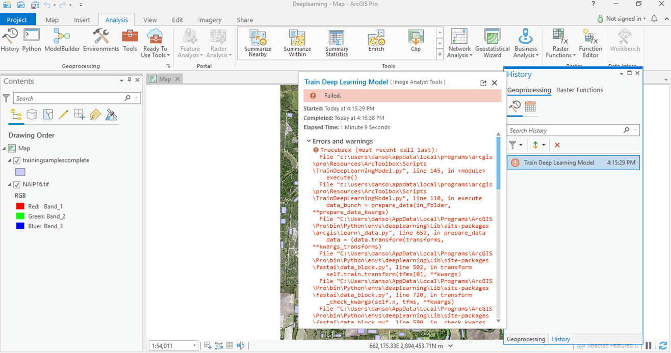

We are learning how to use deep learning and we have been using the examples provided by ESRI with very good results. We started working with our imagery and we are getting the message below. We have followed all the steps and we made sure we installed python. We are not able to identify the problem. Help will be greatly appreciated! Thanks!

ERROR 032659 updateParameters Execution Error: Traceback (most recent call last):File "c:\program files\arcgis\pro\Resources\ArcToolbox\toolboxes\Image Analyst Tools.tbx#TrainDeepLearningModel_ia.UpdateParameters.py", line 1, in <module>File "c:\program files\arcgis\pro\Resources\ArcToolbox\toolboxes\Image Analyst Tools.tbx#TrainDeepLearningModel_ia.UpdateParameters.py", line 66, in updateParametersFile "C:\Program Files\ArcGIS\Pro\bin\Python\envs\arcgispro-py3\Lib\site-packages\arcgis\learn\models\_maskrcnn.py", line 183, in _supported_backbonesreturn [*_resnet_family]NameError: name '_resnet_family' is not defined

Hello Dan,
Many thanks for the reply. Here is the code:
File "c:\......\appdata\local\programs\arcgis\pro\Resources\ArcToolbox\Scripts\TrainDeepLearningModel.py", line 4, in <module>
import arcgis.learn
File "C:\......\AppData\Local\Programs\ArcGIS\Pro\bin\Python\envs\deeplearning\Lib\site-packages\arcgis\__init__.py", line 3, in <module>
from . import (features, geoanalytics, geocoding, geometry,
File "C:\......\AppData\Local\Programs\ArcGIS\Pro\bin\Python\envs\deeplearning\Lib\site-packages\arcgis\features\__init__.py", line 28, in <module>
from . import enrich_data
File "C:\......\AppData\Local\Programs\ArcGIS\Pro\bin\Python\envs\deeplearning\Lib\site-packages\arcgis\features\enrich_data.py", line 10, in <module>
import arcgis.network as network
File "C:\......\AppData\Local\Programs\ArcGIS\Pro\bin\Python\envs\deeplearning\Lib\site-packages\arcgis\network\__init__.py", line 9, in <module>
from . import analysis
File "C:\......\AppData\Local\Programs\ArcGIS\Pro\bin\Python\envs\deeplearning\Lib\site-packages\arcgis\network\analysis.py", line 3, in <module>
from ._vrp import solve_vehicle_routing_problem, edit_vehicle_routing_problem
File "C:\......\AppData\Local\Programs\ArcGIS\Pro\bin\Python\envs\deeplearning\Lib\site-packages\arcgis\network\_vrp.py", line 6, in <module>
from arcgis.mapping import MapImageLayer
File "C:\......\AppData\Local\Programs\ArcGIS\Pro\bin\Python\envs\deeplearning\Lib\site-packages\arcgis\mapping\__init__.py", line 8, in <module>
from ._types import WebMap, WebScene, MapImageLayer, MapImageLayerManager, VectorTileLayer, OfflineMapAreaManager
File "C:\......\AppData\Local\Programs\ArcGIS\Pro\bin\Python\envs\deeplearning\Lib\site-packages\arcgis\mapping\_types.py", line 19, in <module>
from arcgis.widgets import MapView
File "C:\......\AppData\Local\Programs\ArcGIS\Pro\bin\Python\envs\deeplearning\Lib\site-packages\arcgis\widgets\__init__.py", line 2, in <module>
from arcgis.widgets._mapview import MapView
File "C:\......\AppData\Local\Programs\ArcGIS\Pro\bin\Python\envs\deeplearning\Lib\site-packages\arcgis\widgets\_mapview.py", line 15, in <module>
from ipywidgets import widgets
File "C:\......\AppData\Local\Programs\ArcGIS\Pro\bin\Python\envs\deeplearning\Lib\site-packages\ipywidgets\__init__.py", line 23, in <module>
from IPython import get_ipython
File "C:\......\AppData\Local\Programs\ArcGIS\Pro\bin\Python\envs\deeplearning\Lib\site-packages\IPython\__init__.py", line 55, in <module>
from .terminal.embed import embed
File "C:\......\AppData\Local\Programs\ArcGIS\Pro\bin\Python\envs\deeplearning\Lib\site-packages\IPython\terminal\embed.py", line 16, in <module>
from IPython.terminal.interactiveshell import TerminalInteractiveShell
File "C:\......\AppData\Local\Programs\ArcGIS\Pro\bin\Python\envs\deeplearning\Lib\site-packages\IPython\terminal\interactiveshell.py", line 33, in <module>
from .debugger import TerminalPdb, Pdb
File "C:\......\AppData\Local\Programs\ArcGIS\Pro\bin\Python\envs\deeplearning\Lib\site-packages\IPython\terminal\debugger.py", line 8, in <module>
from .shortcuts import suspend_to_bg, cursor_in_leading_ws
File "C:\......\AppData\Local\Programs\ArcGIS\Pro\bin\Python\envs\deeplearning\Lib\site-packages\IPython\terminal\shortcuts.py", line 234, in <module>
from IPython.lib.clipboard import (ClipboardEmpty,
File "C:\......\AppData\Local\Programs\ArcGIS\Pro\bin\Python\envs\deeplearning\Lib\site-packages\IPython\lib\clipboard.py", line 7, in <module>
import IPython.utils.py3compat as py3compat
AttributeError: module 'IPython' has no attribute 'utils'
Failed to execute (TrainDeepLearningModel).
Thanks in advance for your help!
Humberto
