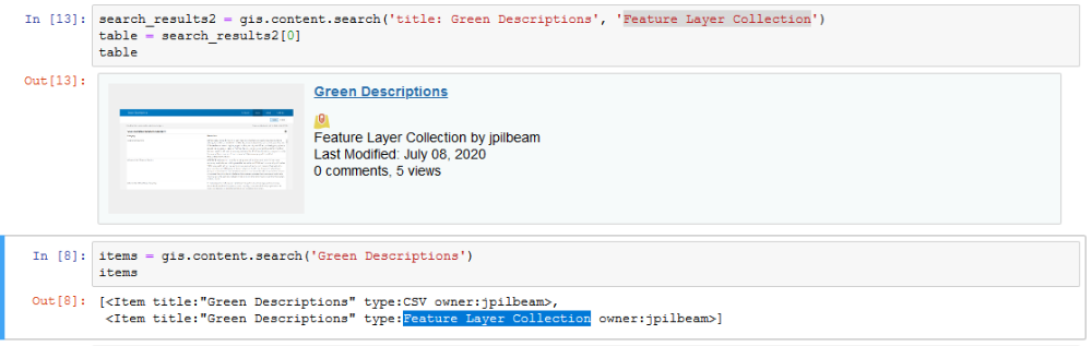

Why is this Table not a table?

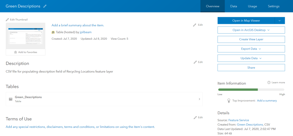

At first I had 'Table' in the type parameter and got [ ]. Then I found out the Table is actually a 'Feature Layer Collection'.
So, that's great. Or so I thought. But, then I get an error telling me the table is not a table?

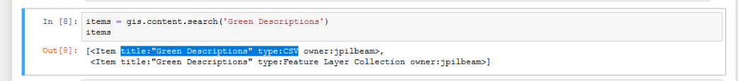

<SPAN class="line-numbers-rows"><SPAN></SPAN><SPAN></SPAN><SPAN></SPAN><SPAN></SPAN><SPAN></SPAN><SPAN></SPAN><SPAN></SPAN><SPAN></SPAN><SPAN></SPAN><SPAN></SPAN><SPAN></SPAN><SPAN></SPAN></SPAN>I then tried the Green Descriptions CSV but got the same error.
