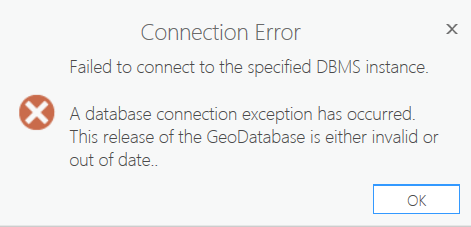

Anyone know what is causing this error or how to fix it? I am brand new to ArcGIS Pro and I am trying to connect to our existing SDE database. I have no issues with this connection in ArcMAP 10.3 and I verified my login credentials so that's not the issue.
Thanks!
As per link I don't believe SQL Server 2008 is supported:
Microsoft SQL Server database requirements for ArcGIS Pro 2.1—Help | ArcGIS Desktop
In addition, I believe you will need a 64-bit SQL Server Native Client installed on your machine.
I would say that is probably the issue! 2008 isn't supported. We are upgrading to 2016 sometime in the next year or so, guess I will have to wait.
Thanks for the help, Michael!
Of course I am going to be asked questions I don't know answers to, ha! SQL Server 2008 I believe, is this what you are asking for?
ArcMap is a 32-bit application and Pro is a 64-bit application so your database client for Pro would be different from your database client for ArcMap.
What type of database are you trying to connect to?
