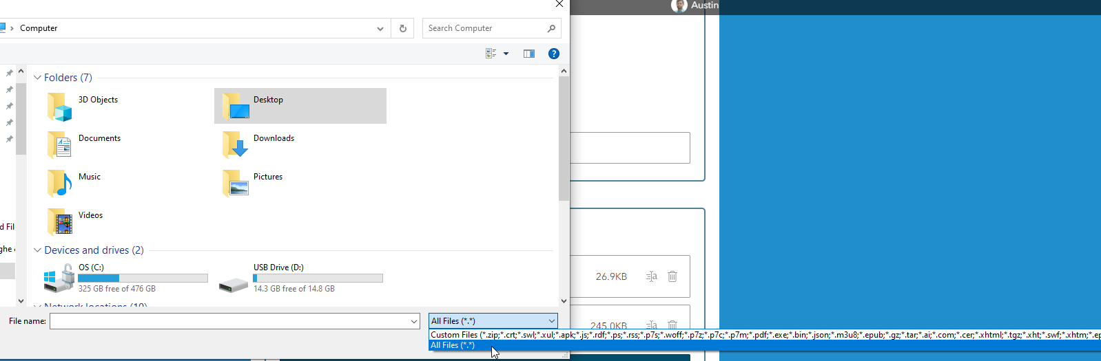

I understand that version 3.10 allows for the attachment of various file types to survey form. There appears to be a default list of file extensions that are allowed for this question, but the user can also choose "All files" to include other file types. Is it possible to modify this default list of allowed file extensions, or maybe make "All Files" the default option?

Hi Austin,
Sorry, I just realised you are using file question type in the web app and not the field app based on your screenshot above. The response I gave above was relevant for the field app, not for the web app.
Did you use the web designer or Survey123 Connect to publish the survey?
If you create the survey via web designer with a "file upload" question type, you get the option of 3 allowed file types, this can be Document, Archive or Custom. If you use custom you can leave it blank, and all supported file types can be selected. Or you can specify just the few you want the user to select.
When using Custom left empty when I open in the web app, I can see all supported types under the file chooser with the Customized files selection:
I just did some further testing and found that when use Survey123 Connect to publish the survey with a file question, open in the web app, it will default to "Customized Files" with a list that is not fully complete the same as if I published from web designer:
This appears to be a bug which I will follow up with our website team, in the meantime the best workaround is to just select "All Files" so that you can select the required file type.

That's not what I'm finding in this case. For the submitter to attach a .DOC or .JPG they must select "All Files" for those files types to be visible. Otherwise, it only shows a custom list of file extensions.
The list of all supported file types can found here: Media—ArcGIS Survey123 | Documentation.
Note that this list matches the supported file types that can be uploaded into ArcGIS Online or Enterprise. Other file types are not supported as they can not be uploaded successfully.
Therefore selecting the default custom file list or all files will have no difference, as only the supported list of files can be used, or your survey will fail to submit.
