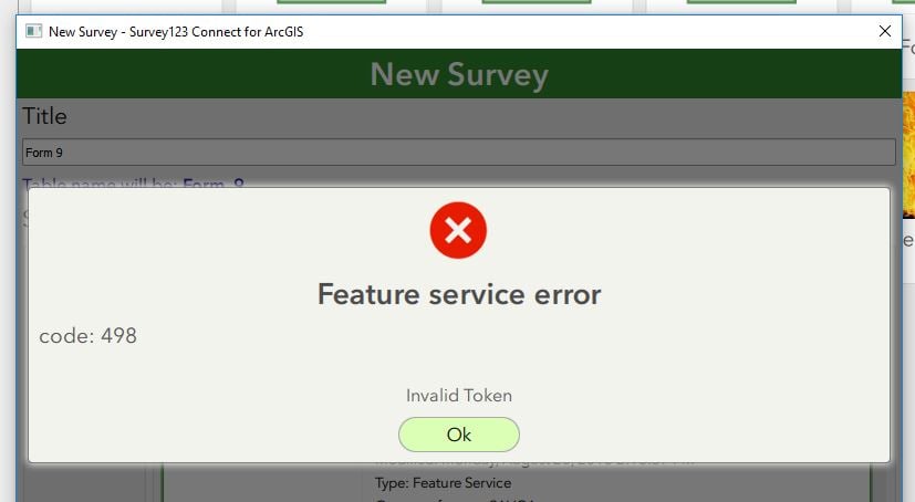

I am trying to use an existing feature service to create my survey. We published the feature layer but I get 'invalid token error :498 whenever I am trying to create a survey from that feature service. Need Help please.

I am having the same problem. I do not understand what you mean by "include the username/password in the item details to make a proxied service" and I do not see anything about that in the technical article you referenced. I created a service in ArcGIS Server from an SDE feature class that was not registered as version, had global Ids, and was archive enabled. I went to AGOL and added it as an item from the web using the rest endpoint. I am able to view the service in the map viewer on AGOL. The service shows up when I search for it when creating a new survey from a Feature Service in Survey123 Connect. But when I try to create a survey from it I get Error Code 498. Please let me know what it is I am doing wrong. Thank you.

Thank You James. I did , but it still giving me the same 'invalid token'.
