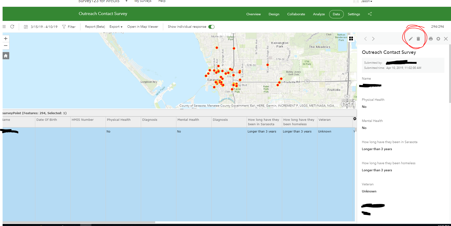

I created a survey for another department in my city. The users collecting the survey information would like the ability to go back and change that data "on the fly". I know that you can do this within the app and also directly through arcgis online. However I have the option to do so within the survey123.arcgis.com interface for the survey. However this is not showing up for anyone but me. Is there a way to change this setting to be available for others or is it a creator of the survey only function.

Hi Jason,
Editing a survey via the Survey123 website and Data tab is a new feature we are working on and has currently only been implemented for the survey owner. In a future release this functionality will be expanded to allow other users that have the survey shared to them and ability to edit records to be able to edit via the website Data page too.
