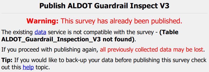

So I wanted to reorganize my questions and when I went to publish I received this message. I have the data local so if it was lost its not a huge issue but I would rather keep my dataset together. I thought the new updates allowed for changes? I am not sure why it would say the table is not found as I did not change anything in AGO.

The update allowed for revising the surveys authored on the Survey123 *website*; no improvement has been made to Survey123Connect.
Is this an old survey Ron?
It might be possible to fool the survey into thinking this table exists by renaming the existing table in the REST endpoint of the feature service (https://blogs.esri.com/esri/arcgis/files/2014/10/How-to-Update-Hosted-Feature-Service-Schemas1.pdf )
Check what table name the feature service currently has by heading to the item details of it. It should be listed under 'Layers'.
Before trying this on the live service, I'd take a copy and try it there first.
