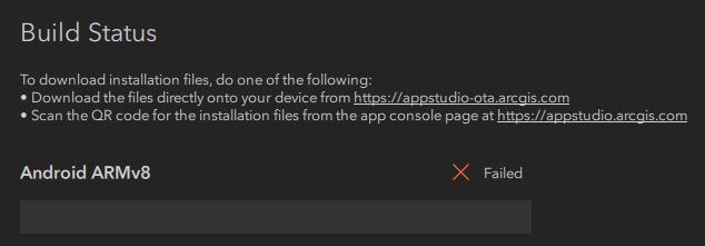

Hi,
When trying to build my apk using the cloud make it fails and the only error message that it shows is 'Failed'. The keystore file has been used before to sign the app. As it is an update to an existing app i need to sign the apk with the same keystore file. Do you have any logs or anything that could help me find out why the build fails?
Best regards
Kamran

Kamran,
I am seeing this error message on the builds from this username agol.ig.ky
============================================================ Certificate Check ============================================================ appBuildId is 122317 platform is androidarm64 builddir is /home/appfactory/buildslaves/appfactory-slave-androidarm64-1/current-androidarm64/build Android keystore could not be opened, perhaps invalid or password was incorrect keytool error: java.io.IOException: Keystore was tampered with, or password was incorrect java.io.IOException: Keystore was tampered with, or password was incorrect at sun.security.provider.JavaKeyStore.engineLoad(JavaKeyStore.java:780) at sun.security.provider.JavaKeyStore$JKS.engineLoad(JavaKeyStore.java:56) at sun.security.provider.KeyStoreDelegator.engineLoad(KeyStoreDelegator.java:224) at sun.security.provider.JavaKeyStore$DualFormatJKS.engineLoad(JavaKeyStore.java:70) at java.security.KeyStore.load(KeyStore.java:1445) at sun.security.tools.keytool.Main.doCommands(Main.java:823) at sun.security.tools.keytool.Main.run(Main.java:366) at sun.security.tools.keytool.Main.main(Main.java:359) Caused by: java.security.UnrecoverableKeyException: Password verification failed at sun.security.provider.JavaKeyStore.engineLoad(JavaKeyStore.java:778) ... 7 more
