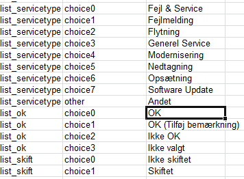

However, we updated some choice lists in Survey123 Excel. This update dosent seem to update the Rest service - even after republishing the service.
The choice list [list_ok] had originally only one choice option [OK] and was published. Now we updated it with 4 in choices in total.

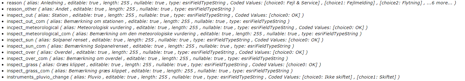

After re-publishing the survey through Survey123, the rest service isent updating its coded values - See inspect_* - it only contains choice0: OK
Does anyone have an idea on why the coded values arent updated?
