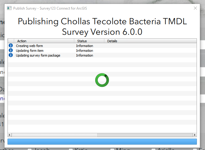

I have had the occasion several times with different surveys "getting stuck" and not publishing. The screen that it gets stuck on is attached. I am able to publish other surveys again without restarting or rebooting the program. My only solution is to create a new survey. This has happened enough times to get rather inefficient. Does anyone else have this issue and have a solution?

I was trying republish the survey and got stuck there. The change I made was deleting some of the lists in the choice sheets. I didn't touch anything else.
Three actions were in the list (all same as the screenshot), and the change I made didn't published.
