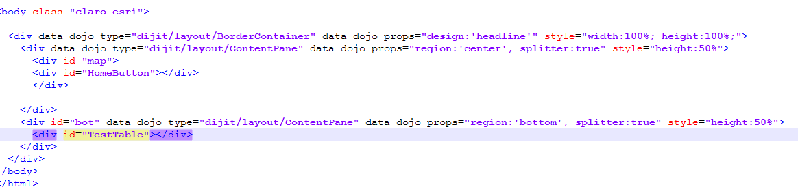

You should always place another div inside the ContentPane that has the id where you will place your map (don't give a contentpane the id="map"):
<div data-dojo-type="dijit/layout/ContentPane" data-dojo-props="region:'center', splitter:true" style="height:50%"> <div id="map" class="map"> <div id="HomeButton"></div> </div> </div>
Can you post all your code or send a link to your site?
Hi Rickey,
I tried placing it the way you suggested it, still no luck though.
Any ideas what else could be causing the alignment?
Best,
Francisco
This seems to work fine for me (I built an app based on the code you show):
<!DOCTYPE HTML> <html> <head> <meta charset="utf-8"> <meta name="viewport" content="initial-scale=1, maximum-scale=1,user-scalable=no"> <title>Home Extent</title> <link rel="stylesheet" href="https://js.arcgis.com/3.16/esri/css/esri.css"> <style> html, body, #map { padding:0; margin:0; height:100%; } #HomeButton { display: block; position: absolute; top: 90px; left: 20px; z-index: 2; } </style> <script src="//js.arcgis.com/3.16/"></script> <script> require([ "esri/map", "esri/dijit/HomeButton", "dojo/parser", "dijit/layout/BorderContainer", "dijit/layout/ContentPane", "dojo/domReady!" ], function( Map, HomeButton, parser ) { parser.parse(); var map = new Map("map", { center: [-56.049, 38.485], zoom: 3, basemap: "streets" }); var home = new HomeButton({ map: map }, "HomeButton"); home.startup(); }); </script> </head> <body class="claro esri"> <div data-dojo-type="dijit/layout/BoarderContainer" data-dojo-props="design:'headline'" style="width:100%; height:100%"> <div data-dojo-type="dijit/layout/ContentPane" data-dojo-props="region:'center', splitter:true" style="height:50%"> <div id="map" class="map"> <div id="HomeButton"></div> </div> </div> <div data-dojo-type="dijit/layout/ContentPane" data-dojo-props="region:'bottom', splitter:true" style="height:50%"> <div id="TesTable"></div> </div> </div> </body> </html>
