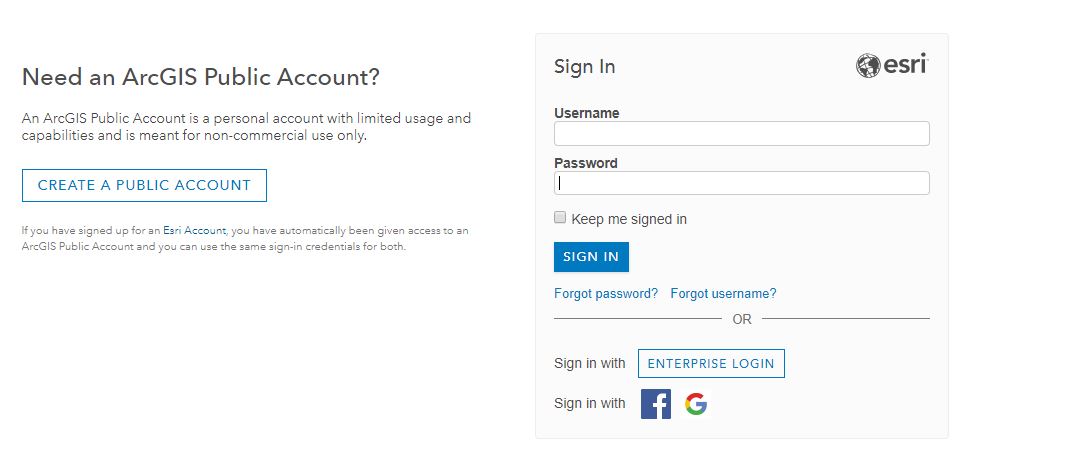

Good Day,
I want to use Esri's sign in page within my application so that the user (the general public) can create a public account before using my app. Then redirect them to my app when they have signed in. I am not using any private or confidential information. All information published is for the public therefore I do not see the need in using OAuth. I just want then to sign in and then be able to access my app as a signed in user. How can I do this? Thank you.
I don't think the OAuth samples hit the standard AGOL sign in page that includes the "Create Public Account" link. You could present the user with a WebView that launches the standard sign in page where they could create an account, I'm just not sure how, once they have created the account, you would obtain the access token from the WebView for your app to use from then on.
However, I'm unsure of what you're trying to achieve? Is the content your app consumes publicly available? If yes, then why do you need the user to sign in at all? If not, then a 'Public Account' will not be able to access private content secured in your AGOL account, only actual named users who the content has been shared to, in which case you would use the standard OAuth workflow and samples to sign them in.

So you *can* use the OAuth workflow, the only missing step here potentially is the ability to actually create the public account within the AppStudio app itself. Like I mentioned before, the OAuth sample sign in page doesn't include the "Create Public Account" link. So one option would be to bounce the user out of the app to a native web browser to www.arcgis.com with a message to create an account and then ask them to return to the app and sign in. But that's not an ideal workflow.
The next options to explore would be either using a WebView to present https://www.arcgis.com/home/createaccount.html and somehow detect when they have created the account and grab the token etc. Or examine the rest api calls made in this workflow and code them into actual QML page controls to create that account and parse the results to get the token etc.
