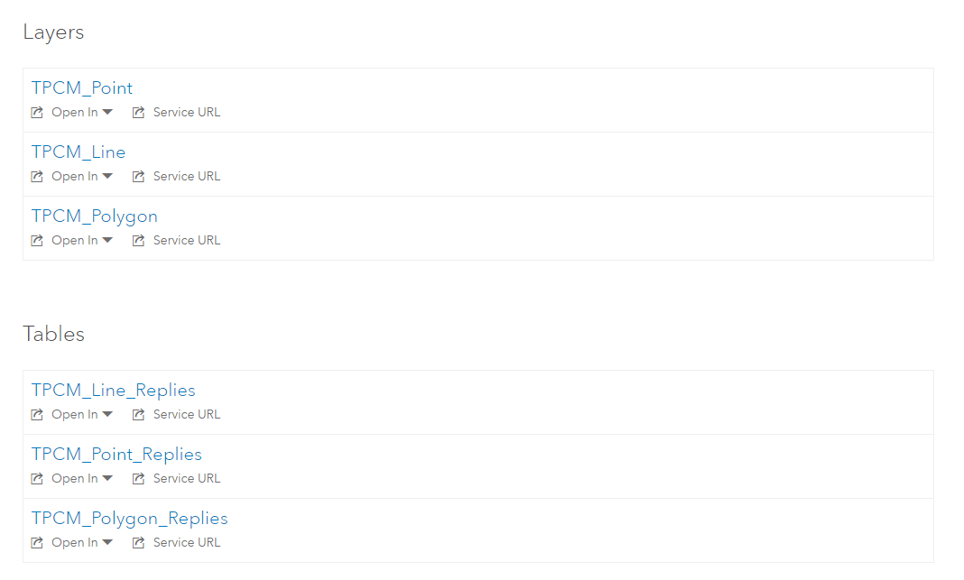

So I created a new feature service (Feature Layer Collection) into a folder. It is an empty feature service with layers and table relationships. Each layer has a geometry type. I only want points. How can I delete the line and polygon layers and tables using the ArcGIS API for python? I will continue to read documentation and if I figure it out I will post back here.

This makes sense for deleting the feature service completely, but as for deleting its layers or tables it doesn't make sense to me. I can access the object (see comment below this one) but if I use the delete method on the object I get
AttributeError: 'FeatureLayer' object has no attribute 'delete'
If I ask for the object's id I get 1, which is local to the feature service itself.
I guess what I mean by feature service is that it's a feature layer collection.
