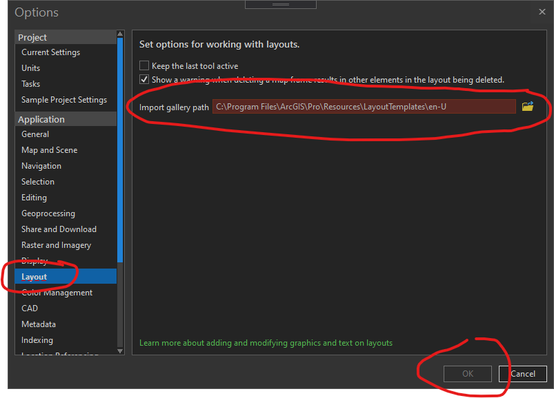

I followed the sample here ProGuide Custom settings · Esri/arcgis-pro-sdk Wiki · GitHub and have added my own add-in settings to the backstage. I've binded several properties to the UI and it works great. I have a textbox where the user can browse to a folder where our company's data exists. If the user inputs an invalid folder I wanted to change the backcolor of the textbox and set the OK button to disabled until the input is fixed. A similar thing is done with the Layout options.
Ive looked in the community samples and looked at the Pro SDK and cant find anything. Where would I add my validation logic to mimic the existing Layout options?
