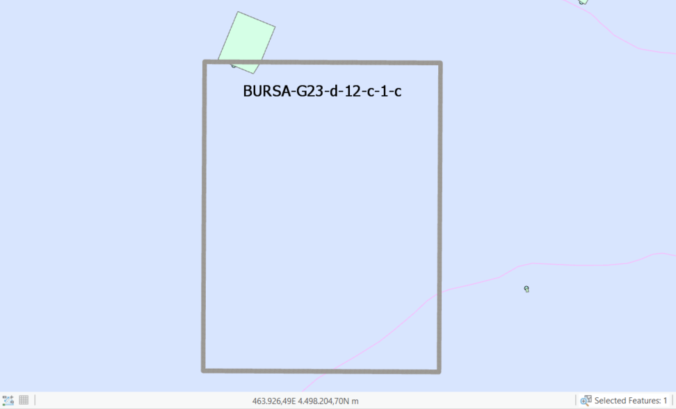

We are develope commands for arcgis pro sdk 2.2 version.We have text and polygon geometry inputs. How can we add these (text and polgon) graphically on map without annotation or feature class ? Can do it as Annotation also I can do polygon overlay (using MapView.Active.AddOverlay function) but but I want to create a graph with both polygon and te text like below in picture?How can I solve this problem?
Thaks for Helping
Here is a code snippet to create an overlay with text. This code is from a sample Map Tool:
<SPAN class="keyword token">internal</SPAN> <SPAN class="keyword token">class</SPAN> <SPAN class="token class-name">AddOverlayWithText</SPAN> <SPAN class="punctuation token">:</SPAN> MapTool <SPAN class="punctuation token">{</SPAN> <SPAN class="keyword token">private</SPAN> IDisposable _graphic <SPAN class="operator token">=</SPAN> <SPAN class="keyword token">null</SPAN><SPAN class="punctuation token">;</SPAN> <SPAN class="keyword token">private</SPAN> CIMPolygonSymbol _polygonSymbol <SPAN class="operator token">=</SPAN> <SPAN class="keyword token">null</SPAN><SPAN class="punctuation token">;</SPAN> <SPAN class="keyword token">public</SPAN> <SPAN class="token function">AddOverlayWithText</SPAN><SPAN class="punctuation token">(</SPAN><SPAN class="punctuation token">)</SPAN> <SPAN class="punctuation token">{</SPAN> IsSketchTool <SPAN class="operator token">=</SPAN> <SPAN class="keyword token">true</SPAN><SPAN class="punctuation token">;</SPAN> SketchType <SPAN class="operator token">=</SPAN> SketchGeometryType<SPAN class="punctuation token">.</SPAN>Polygon<SPAN class="punctuation token">;</SPAN> SketchOutputMode <SPAN class="operator token">=</SPAN> SketchOutputMode<SPAN class="punctuation token">.</SPAN>Map<SPAN class="punctuation token">;</SPAN> <SPAN class="punctuation token">}</SPAN> <SPAN class="keyword token">protected</SPAN> <SPAN class="keyword token">override</SPAN> <SPAN class="keyword token">async</SPAN> Task<SPAN class="operator token"><</SPAN><SPAN class="keyword token">bool</SPAN><SPAN class="operator token">></SPAN> <SPAN class="token function">OnSketchCompleteAsync</SPAN><SPAN class="punctuation token">(</SPAN>Geometry geometry<SPAN class="punctuation token">)</SPAN> <SPAN class="punctuation token">{</SPAN> <SPAN class="comment token">//Add an overlay graphic to the map view</SPAN> _polygonSymbol <SPAN class="operator token">=</SPAN> SymbolFactory<SPAN class="punctuation token">.</SPAN>Instance<SPAN class="punctuation token">.</SPAN><SPAN class="token function">ConstructPolygonSymbol</SPAN><SPAN class="punctuation token">(</SPAN>ColorFactory<SPAN class="punctuation token">.</SPAN>Instance<SPAN class="punctuation token">.</SPAN>BlackRGB<SPAN class="punctuation token">,</SPAN> SimpleFillStyle<SPAN class="punctuation token">.</SPAN>Null<SPAN class="punctuation token">,</SPAN> SymbolFactory<SPAN class="punctuation token">.</SPAN>Instance<SPAN class="punctuation token">.</SPAN><SPAN class="token function">ConstructStroke</SPAN><SPAN class="punctuation token">(</SPAN>ColorFactory<SPAN class="punctuation token">.</SPAN>Instance<SPAN class="punctuation token">.</SPAN>BlackRGB<SPAN class="punctuation token">,</SPAN> <SPAN class="number token">2.0</SPAN><SPAN class="punctuation token">,</SPAN> SimpleLineStyle<SPAN class="punctuation token">.</SPAN>Solid<SPAN class="punctuation token">)</SPAN><SPAN class="punctuation token">)</SPAN><SPAN class="punctuation token">;</SPAN> _graphic <SPAN class="operator token">=</SPAN> <SPAN class="keyword token">await</SPAN> <SPAN class="keyword token">this</SPAN><SPAN class="punctuation token">.</SPAN><SPAN class="token function">AddOverlayAsync</SPAN><SPAN class="punctuation token">(</SPAN>geometry<SPAN class="punctuation token">,</SPAN> _polygonSymbol<SPAN class="punctuation token">.</SPAN><SPAN class="token function">MakeSymbolReference</SPAN><SPAN class="punctuation token">(</SPAN><SPAN class="punctuation token">)</SPAN><SPAN class="punctuation token">)</SPAN><SPAN class="punctuation token">;</SPAN> <SPAN class="comment token">//define the text symbol</SPAN> <SPAN class="keyword token">var</SPAN> textSymbol <SPAN class="operator token">=</SPAN> <SPAN class="keyword token">new</SPAN> <SPAN class="token class-name">CIMTextSymbol</SPAN><SPAN class="punctuation token">(</SPAN><SPAN class="punctuation token">)</SPAN><SPAN class="punctuation token">;</SPAN> <SPAN class="comment token">//define the text graphic</SPAN> <SPAN class="keyword token">var</SPAN> textGraphic <SPAN class="operator token">=</SPAN> <SPAN class="keyword token">new</SPAN> <SPAN class="token class-name">CIMTextGraphic</SPAN><SPAN class="punctuation token">(</SPAN><SPAN class="punctuation token">)</SPAN><SPAN class="punctuation token">;</SPAN> <SPAN class="keyword token">await</SPAN> QueuedTask<SPAN class="punctuation token">.</SPAN><SPAN class="token function">Run</SPAN><SPAN class="punctuation token">(</SPAN><SPAN class="punctuation token">(</SPAN><SPAN class="punctuation token">)</SPAN> <SPAN class="operator token">=</SPAN><SPAN class="operator token">></SPAN> <SPAN class="punctuation token">{</SPAN> <SPAN class="comment token">//Create a simple text symbol</SPAN> textSymbol <SPAN class="operator token">=</SPAN> SymbolFactory<SPAN class="punctuation token">.</SPAN>Instance<SPAN class="punctuation token">.</SPAN><SPAN class="token function">ConstructTextSymbol</SPAN><SPAN class="punctuation token">(</SPAN>ColorFactory<SPAN class="punctuation token">.</SPAN>Instance<SPAN class="punctuation token">.</SPAN>BlackRGB<SPAN class="punctuation token">,</SPAN> <SPAN class="number token">8.5</SPAN><SPAN class="punctuation token">,</SPAN> <SPAN class="string token">"Corbel"</SPAN><SPAN class="punctuation token">,</SPAN> <SPAN class="string token">"Regular"</SPAN><SPAN class="punctuation token">)</SPAN><SPAN class="punctuation token">;</SPAN> <SPAN class="comment token">//Sets the geometry of the text graphic</SPAN> textGraphic<SPAN class="punctuation token">.</SPAN>Shape <SPAN class="operator token">=</SPAN> geometry<SPAN class="punctuation token">;</SPAN> <SPAN class="comment token">//Sets the text string to use in the text graphic</SPAN> textGraphic<SPAN class="punctuation token">.</SPAN>Text <SPAN class="operator token">=</SPAN> <SPAN class="string token">"This is my polygon"</SPAN><SPAN class="punctuation token">;</SPAN> <SPAN class="comment token">//Sets symbol to use to draw the text graphic</SPAN> textGraphic<SPAN class="punctuation token">.</SPAN>Symbol <SPAN class="operator token">=</SPAN> textSymbol<SPAN class="punctuation token">.</SPAN><SPAN class="token function">MakeSymbolReference</SPAN><SPAN class="punctuation token">(</SPAN><SPAN class="punctuation token">)</SPAN><SPAN class="punctuation token">;</SPAN> <SPAN class="comment token">//Draw the overlay text graphic</SPAN> _graphic <SPAN class="operator token">=</SPAN> <SPAN class="keyword token">this</SPAN><SPAN class="punctuation token">.</SPAN>ActiveMapView<SPAN class="punctuation token">.</SPAN><SPAN class="token function">AddOverlay</SPAN><SPAN class="punctuation token">(</SPAN>textGraphic<SPAN class="punctuation token">)</SPAN><SPAN class="punctuation token">;</SPAN> <SPAN class="punctuation token">}</SPAN><SPAN class="punctuation token">)</SPAN><SPAN class="punctuation token">;</SPAN> <SPAN class="keyword token">return</SPAN> <SPAN class="keyword token">true</SPAN><SPAN class="punctuation token">;</SPAN> <SPAN class="punctuation token">}</SPAN> <SPAN class="punctuation token">}</SPAN><SPAN class="line-numbers-rows"><SPAN></SPAN><SPAN></SPAN><SPAN></SPAN><SPAN></SPAN><SPAN></SPAN><SPAN></SPAN><SPAN></SPAN><SPAN></SPAN><SPAN></SPAN><SPAN></SPAN><SPAN></SPAN><SPAN></SPAN><SPAN></SPAN><SPAN></SPAN><SPAN></SPAN><SPAN></SPAN><SPAN></SPAN><SPAN></SPAN><SPAN></SPAN><SPAN></SPAN><SPAN></SPAN><SPAN></SPAN><SPAN></SPAN><SPAN></SPAN><SPAN></SPAN><SPAN></SPAN><SPAN></SPAN><SPAN></SPAN><SPAN></SPAN><SPAN></SPAN><SPAN></SPAN><SPAN></SPAN><SPAN></SPAN><SPAN></SPAN><SPAN></SPAN><SPAN></SPAN><SPAN></SPAN><SPAN></SPAN><SPAN></SPAN></SPAN>
This code creates an overlay like this:
