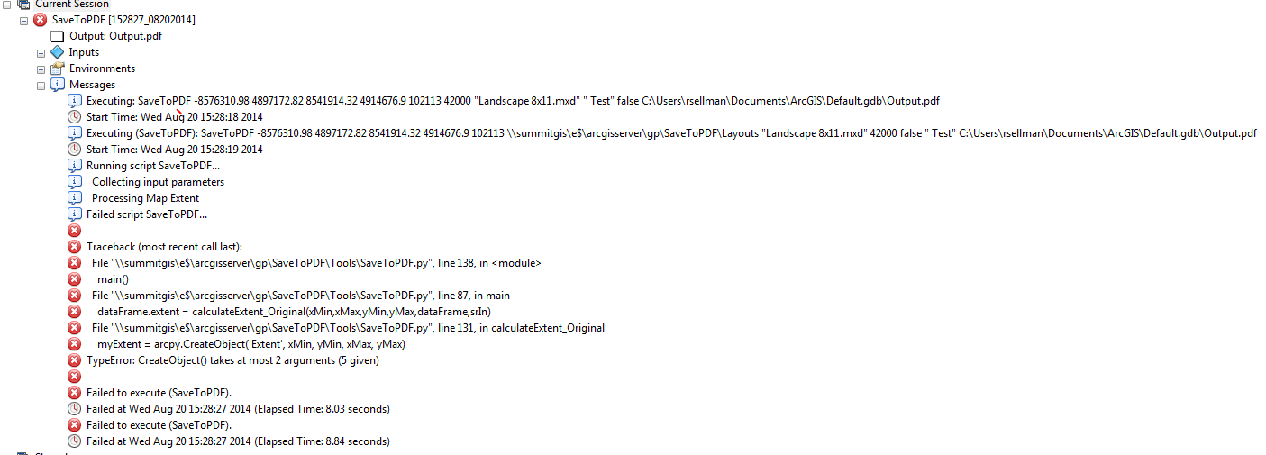

I downloaded the Save to PDF script from the this resources on arcgis.com. I am trying to get it to run in ArcMap but am consistently getting the error shown in this image:
What I want to do is publish the results as a Geoprocessing Service to ArcGIS Server, but can't get it to run correctly in ArcGIS Desktop. Any thoughts as to whats going on here?
