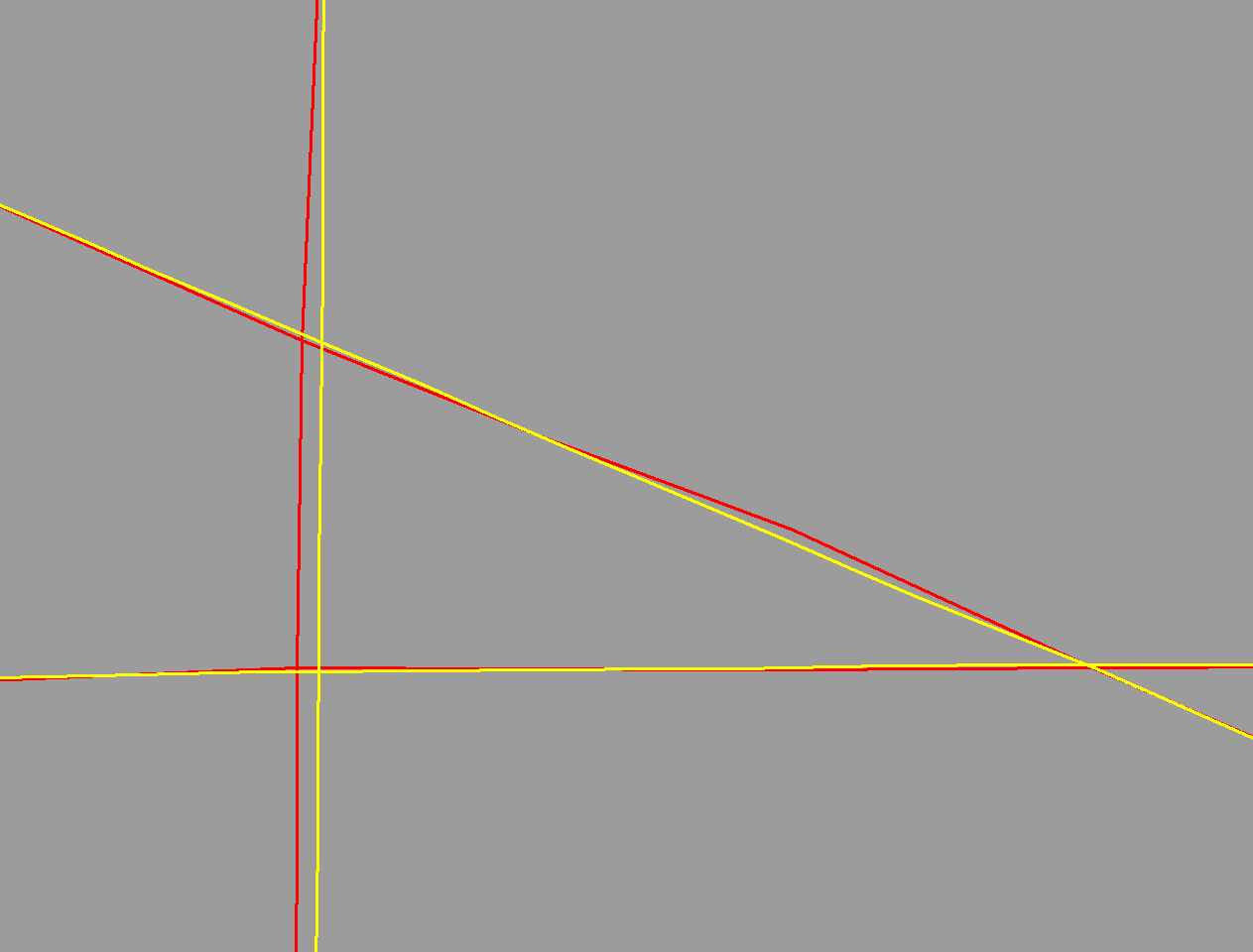

I have two different sets of center lines (none attributes in common). I am trying to transfer the attribute data from one to another. I tried to use Thiessen polygons to achieve this but it does not work. I ran out of ideas so I will appreciate if someone can help me out with this.

Thanks for the message. I have already tried the spatial join. The problem is that the polylines are also segmented differently, and I couldn’t find a way to set more rules the moment that I did the spatial join.
