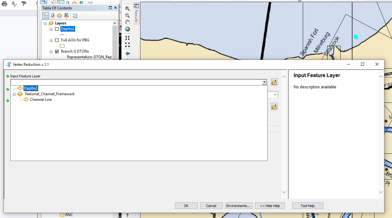

lyrInput<SPAN class="punctuation token">.</SPAN>filter<SPAN class="punctuation token">.</SPAN>list <SPAN class="operator token">=</SPAN> <SPAN class="punctuation token">[</SPAN><SPAN class="string token">"Polyline"</SPAN><SPAN class="punctuation token">]</SPAN><SPAN class="line-numbers-rows"><SPAN></SPAN><SPAN></SPAN><SPAN></SPAN><SPAN></SPAN><SPAN></SPAN><SPAN></SPAN></SPAN>When I open the tool in ArcMap 10.5.1, it shows me the layers that have been added to ArcMap:

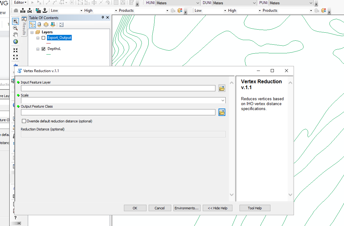

However, when I open it on our virtual servers using ArcMap 10.7.1, the filter doesn't show any layers added to ArcMap. This means that selections won't be applied:
It's the exact same python script on both versions. But, in 10.7.1, nothing shows. I've tried creating a separate script and setting the filter in the properties and, when no filter is added, it shows me in_memory layers but when I set a filter to the feature layer, it doesn't show anything.
