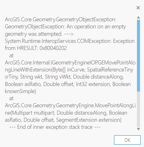

Hi,I cannot use GeometryEngine.Instance.MovePointAlongLine method with polyline has elliptic arc segment(pic. polyline).I have an error like "An operation on an empty geometry was attempted."(pic. error)
pic. polyline
pic. error

Hi taner,
Thank you for pointing out this issue. Yes it is a bug. It will be fixed in the 2.2 release of the software.
Narelle
Hello Taner,
We can confirm this fix is included with the upcoming Pro 2.2 release.
