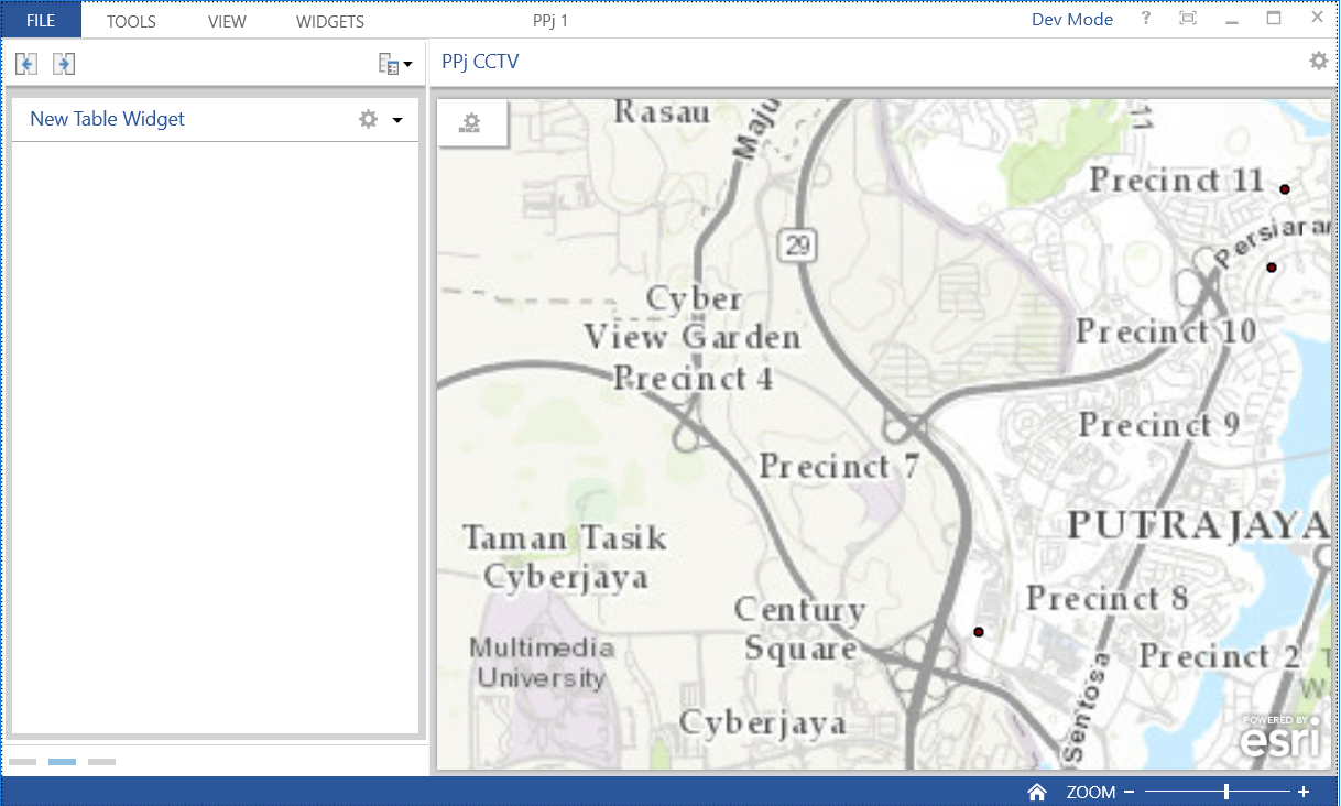

HI, I'm trying the dashboard extensions from https://github.com/Esri/dashboard-samples. In debug mode, after i added e.g. a table widget into the dashboard, all i get is a a blank space. This is using the latest operations Dashboard 10.3.4.1523. How do i get a custom extension working again? I last tried it late last year, it was working then.

Hi Chris,
1) Used http for my portal, still didn't work
2) Nope, no extension work. I tried to build my own simple one, also didn't work.
3) The debug window appears blank to me as well
4) Win 10
5) Yes, browser mode works; it's the only way i can proceed with my development now.
Regards,
Ken Moey
That actually worked. So operations dashboard needs the gpu, if two graphics cards are presnet.
