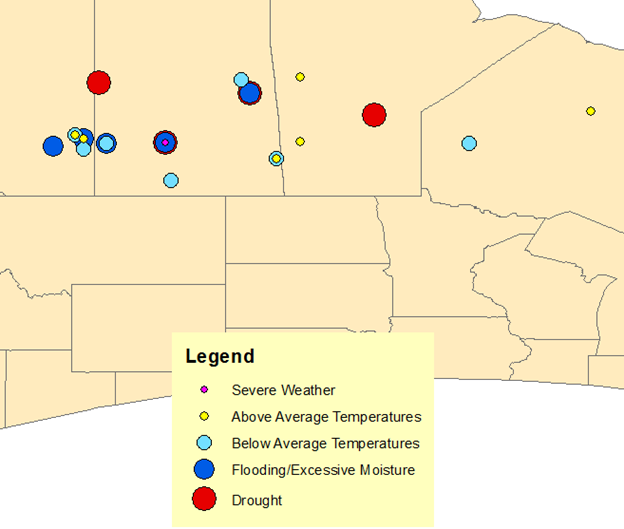

Hey guys. I am looking for a way to represent multiple values for the same point. For example on a single point it is recorded that it experienced flooding and drought. In the my there are 5 values that can be selected and any combination can be selected. I am looking for a way to map the values. I currently have an idea to map it using progressively smaller circles (see screenshot). The problem with this is it over represents the impact of larger circles but under represents the smaller ones. Does any one have any ideas of how to map all these values on the same map?Thanks a lot

I like this but I don't think it works for me. Let me pose a question. How do you symbolize if a point is both a Fuse and a Light? For me they could pick just drought, or drought and flooding, or drought, below avg temperatures and severe weather, or flooding and severe weather, ect. How do a show a point that has any combination of those 5 catagories
Ya okay, that's sort of the conclusion that we had come to here in my office. Just needed confirmation that there wasn't a better way to do it. Thanks to all of you and especially you Robert Borchert
