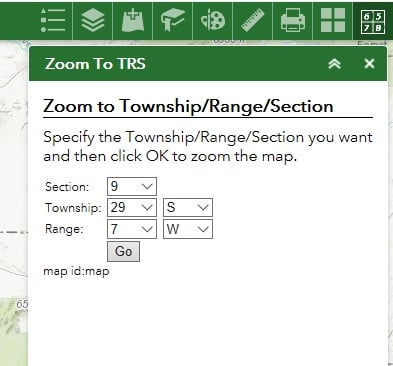

I'm likely making a stupid mistake but right now I'm not seeing it. I'm getting my feet wet with WAB Developer Edition 2.8 and I'm making a simple widget (based on demo widget template in the samplewidgets folder). In my widget, the user specifies a township/range/section and the map zooms to that location. Here's the widget:
Simple stuff. My code works up to the point of updating the map extent. I get an error that the "Object doesn't support property or method 'setExtent'". From my search, I feel like I'm referencing the map the right way but clearly I'm not. What am I missing?
