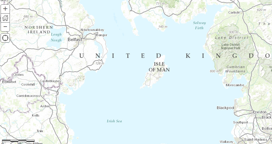

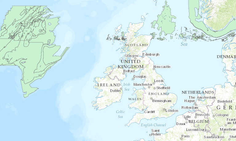

I have a layer in my ArcGIS Online map. It has a lot of features in the layer meaning that ArcGIS Online cannot draw all of them on the map. It suggests to me to play with the "Set Visibility Range" function. I did but it does not seem to show what I want. I want the user to be able to see all of the features in both zoom ranges (see pictures). (The first screenshot is not showing all the features and the second screenshot is not showing the features at all). Which range would be best in "Set Visibility Range"?
the top line of your scale shows the two white down arrows and one black one... the two white arrow are really close together to the far left. The black arrow isn't in between them. Playing around with ranges, what happens to their placement and the visibility of the features?

If you want the features to display at all scale levels drag the left slider all the way to the left and the right slider all the way to the right. However you will still have issue with all of the features displaying...by default a hosted feature layer will only return the first 1,000 records. If you have admin privleges you can modify the service definition or republish the layer from ArcMap where you can modify the Max number of records returned.
I tried your range and it seems more features are visible than before.
