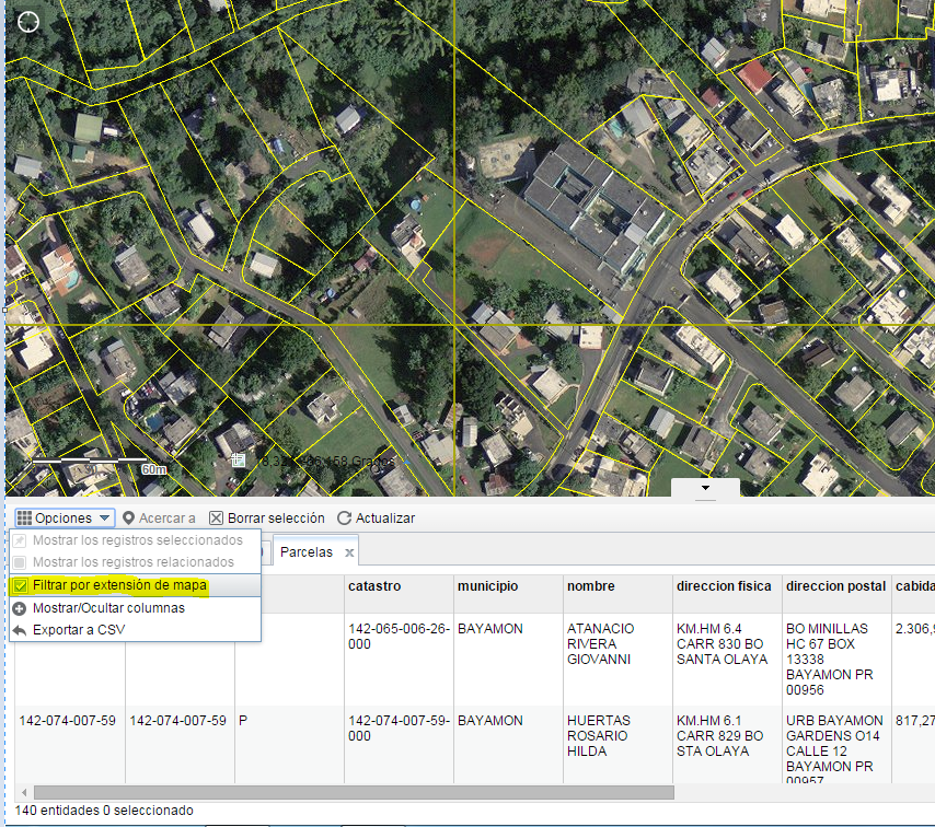

I have a question. I am working with Web Appbuilder. I have a Parcel layer. When i open attribute table for this layer it start loading for the thousands of parcels the layer have. Is there a way to set "filter by extent" option to be activated by default? so the load of the layers is faster

EDIT: So I have experimented and tested and all you have to do is from WAB Dev choose export as template (After you have made your code changes) and the the customized WAB app will become your default WAB template in your AGOL account.

So, I install Developer, download the app and made the changes, Now i upload the app and for some reason it appear as Desktop instead of Web AppBuilder as the one I created.
My question is, How can I make that my app reflect the changes I already did. I am fallowing the steps to register the app but it seems that I need to use my server instead of agol.
