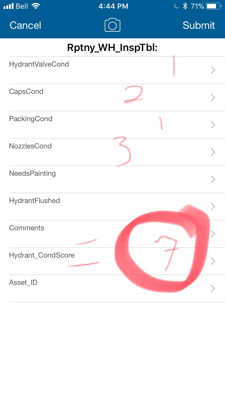

I'm trying to find a way to have field in my Collector app that will calculate and display the results of others fields in the same table. I came across a solution that would imply to use a field calculator (in a domain field using MobelBuilder). But this solution is tedious to implement and I understand the mobile worker would not see the live calculated field(s) in the Collector app. Do any of you have any insights to share with me concerning this auto-calculated field based on data the user have inputted before. Thanks a lot!

Finally we had to create Python Script to do those auto-calculations. I know Survey123 is great in this matter but indeed the workflow involves complex geometry like line and polygon and is more also map-centric. The Collector Aurora version have this in their pipeline I think, I look forward to get my hands on this when this will be released. Thanks Xander!
