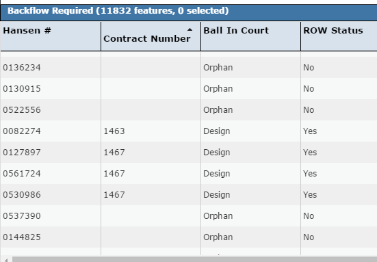

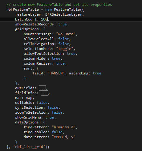

The column sort on our FeatureTable appears to be broken by batchCount. The ascending/descending sort order is correct until the table is scrolled far enough to make another request and then the sort order begins again on the next set of records. What are some of the possible causes/solutions?
How are you creating the input FeatureLayer for the table? If you're using the default MODE_ONDEMAND, what happens when you try using MODE_SNAPSHOT?
