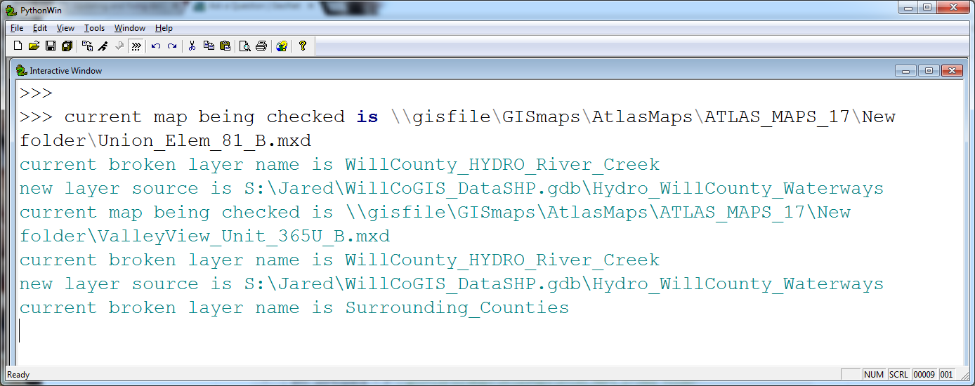

I'm attempting to loop through mxds in a folder replacing any broken layer sources. The script below successfully loops through the entire folder and prints out all the print statements, but it's not replacing the data source. It seems as though the syntax is correct, however?
The code below attempts to replace the source data of 'WillCounty_HYDRO_River_Creek'. As you can see it ran through the whole code, but the path in the replaceDataSource() function on line 20 seemingly didn't work as it was neither printed nor changed in the Layer Properties window (rather, it was changed to S:\Jared...).

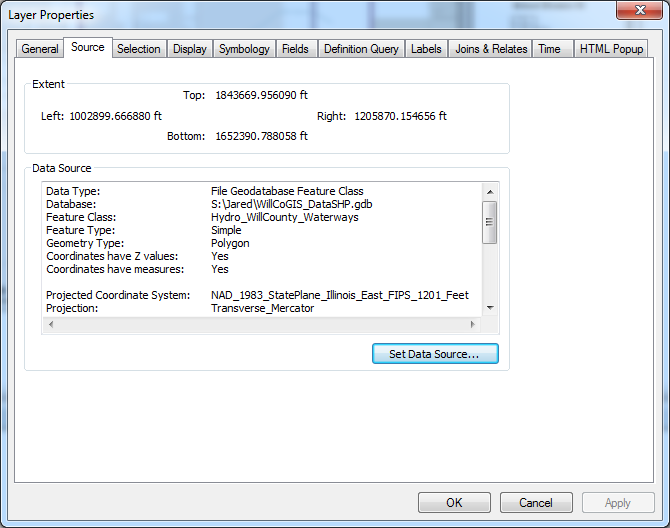

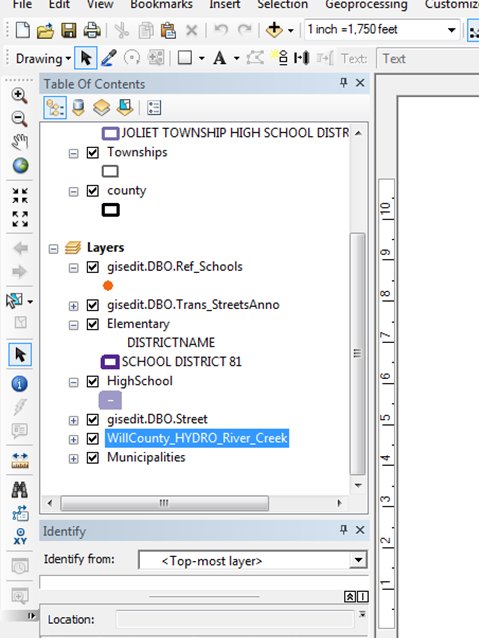

I've included a PrtScn of the Layer Properties window of the layer with the broken source. You'll notice on the Source tab the feature class is called 'Hydro_WillCounty_Waterways', but the same layer in the TOC is called 'WillCounty_HYDRO_River_Creek'. I've tried both to no avail.
