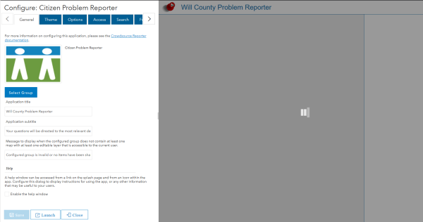

For some reason my Citizen Problem Reporter app will not load. All necessary maps and feature layers are shared with the Citizen Problem Reporter Group. I created this a couple months ago and for some reason yesterday it stopped working. I'm using Firefox and have tried opening it in different browsers too. I can't figure out why.

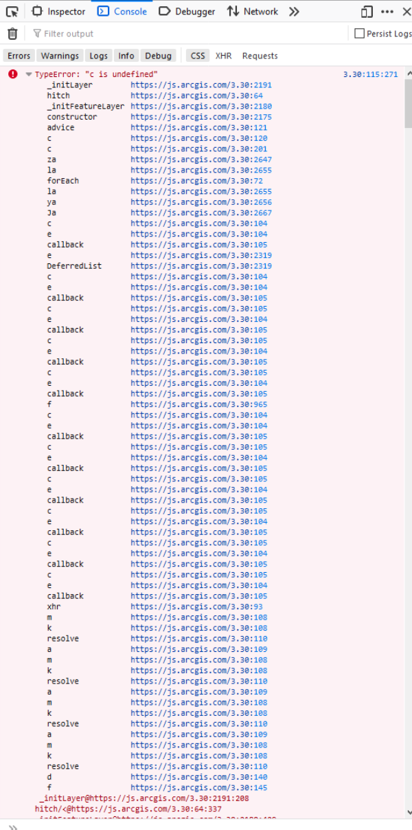

OK, thanks for pointing that out. I opened one of the webmaps and seen there is a Will County Boundary - copy layer there.
But, when I open it in the map viewer Will County Boundary - copy isn't in the Content menu. And then the error pops up. I'd like to delete it from the Overview page but I don't see how?
If I try to open the Will County Boundary - copy layer from the Overview page I get this:
Thanks for sending that, Jared.
When I access the maps (without the app) they give a warning that indicates one of the layers cannot be accessed. From this end it looks like the county boundary layer is inaccessible.
Can you verify that this is shared in the same way as the rest of the layers?

Yes, I haven't made any progress. Sure, here's the link:
https://willcountygis.maps.arcgis.com/apps/CrowdsourceReporter/index.html?appid=b3c9cb95a838496ea499ef64dd14a11c
