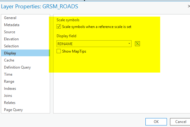

To clarify, in this layer, I made the feature name the "Display Name" and turned off all other fields in Pro. Just care about the name.

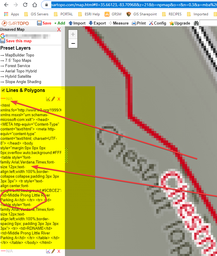

Note that I get no name in SARTOPO, and the raw XML as the attribute.

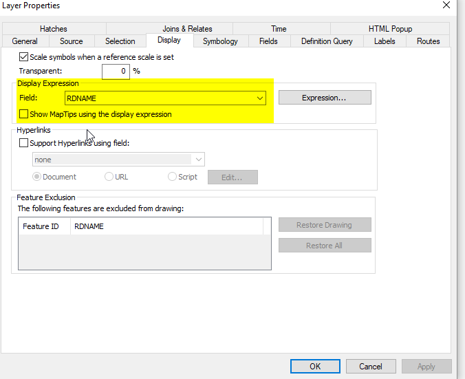

Same workflow in ArcMap:

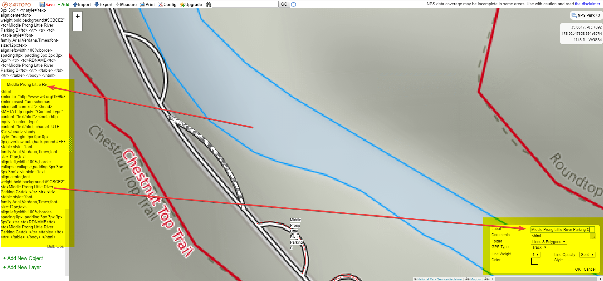

A little better. At least the export to KML (KMZ) honored my Display Name setting, but still the XML in the attribute, which I don't think is ESRI's fault. Where I do point a finger though...

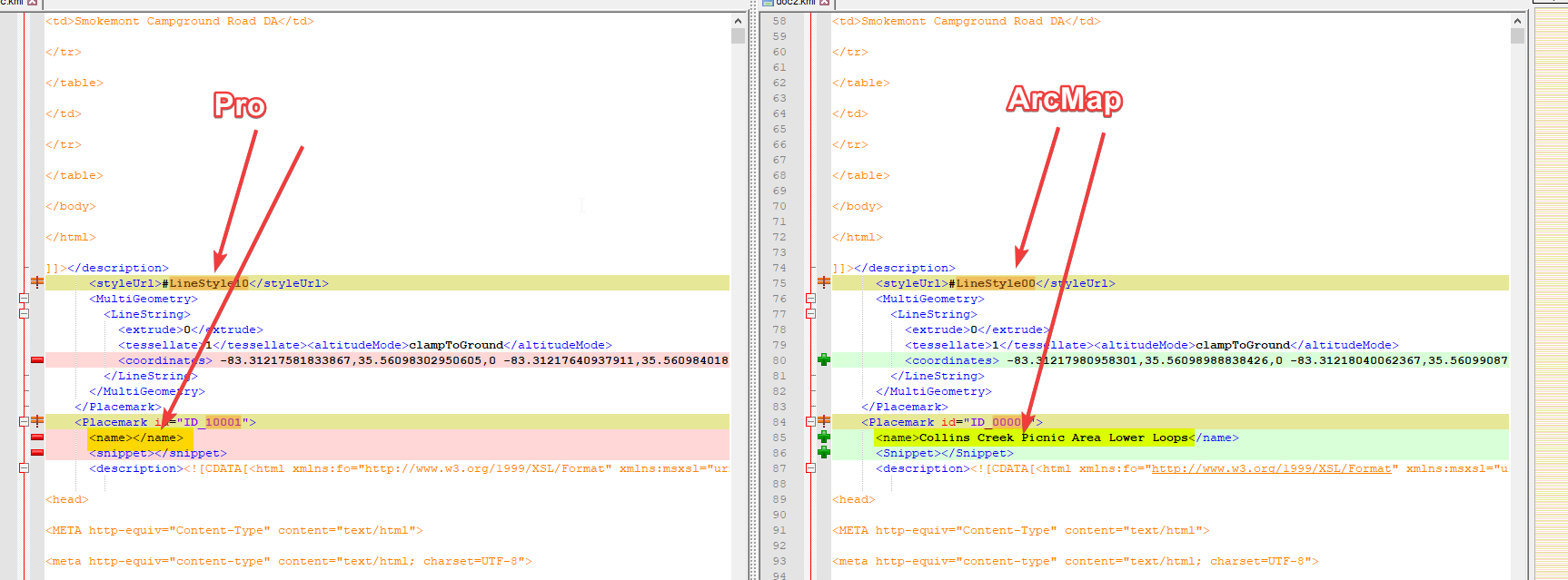

If we look at the raw XML (in the KML in the KMZ)...in both workflows I'm doing this:
But the output of Layer to KML is:
Pro is not honoring the name element.
