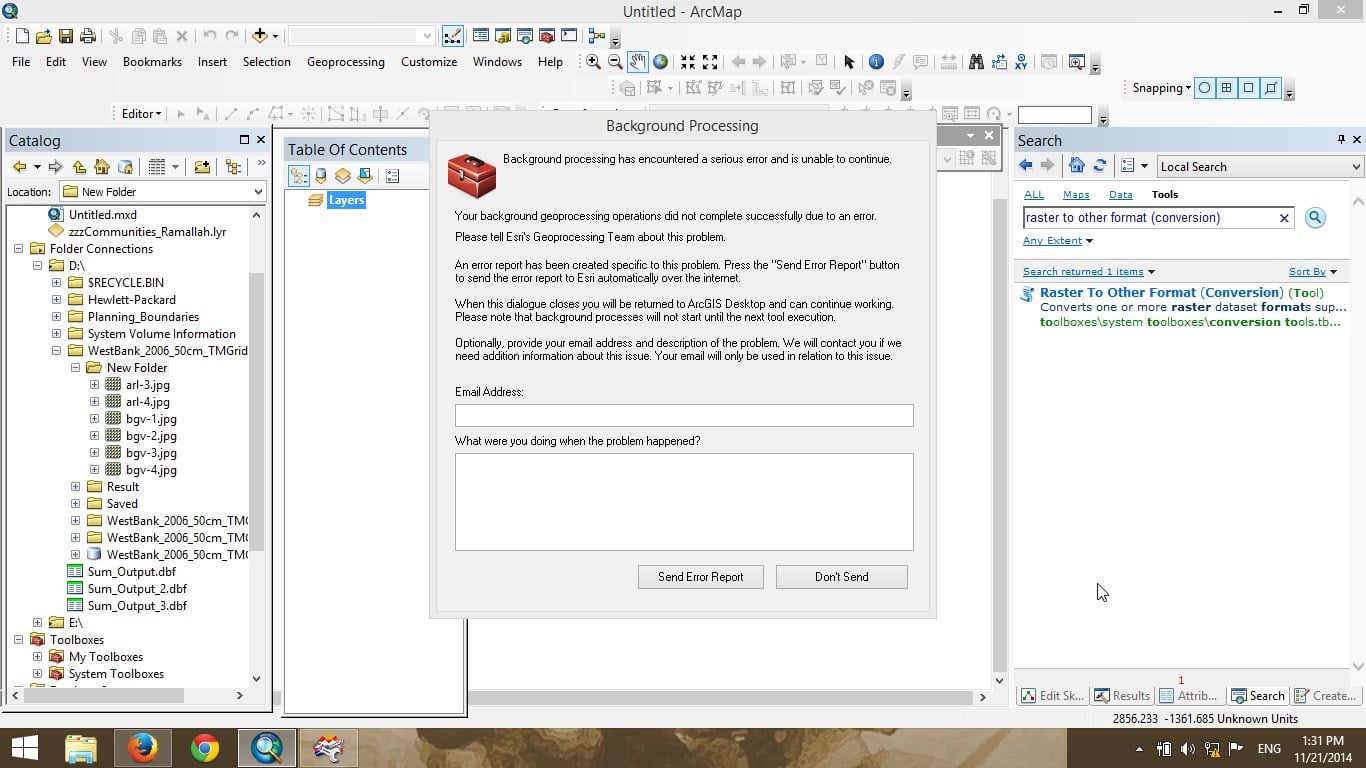

I am trying to convert a batch of ecw aerial photos to jpg in arcmap using the ( Raster to other format) but each time it converts 4 or 5 images and then fails and show this message.
what might be the issue here, I have more than 150GB free on my hard disc and i tried to use more than 1 PC.
Thank you

Yovav Zohar i am very appreciated for your reply. I am afraid that the issue is not solved, see the screenshots.

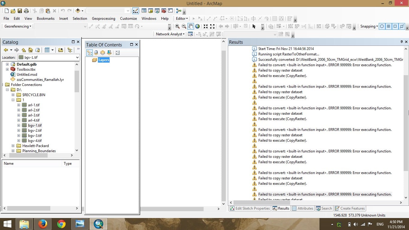

Copy Raster have the same problem
and even the mosaic dataset have problem in the overviews
I think its a problem with this version of ECW images ArcGIS cant deal with it, so as you said I need to contact with ESRI to report his problem.
