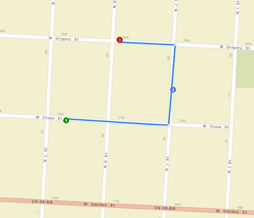

In first case, a) I create 3 stops and request a route analysis. To make the route 'return to start', b) I append the first stop to the last and request again. The result shows that the route geometry vertices (begin point) is difference for the two cases (a and b).
How to make it same ?
Test data and results:
For route analysis, I get 3 stops with address:
1) 1865 W Chase St, Pensacola, Florida, 32502
2) 112 N J St, Pensacola, Florida, 32502
3) 1620 W Gregory St, Pensacola, Florida, 32502
The Curb Approach is Right Side and U-turn policy is ALLOW_BACKTRACK
The stops used in REST API parameters is

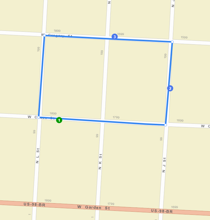

Then I tried to make the route 'return to first stop' by add the last stop same as first stop.
I pass the stop parameters as:
