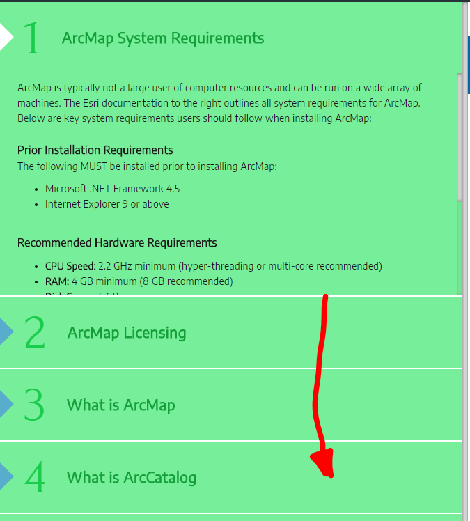

I've downloaded the Map Series template from GitHub and am wondering if it's possible to create a custom CSS rule that would increase the height of the active accordion content window? I'd like to be able to display more text than what is currently visible.
Hi Matt -- The accordion section panel's max height is set by line 197 in the AccordionPanel.js file.
You can adjust the portion of the panel that is dedicated to showing the active content. Currently it's set at 1/3 of the total panel height. Changing the 3 to 2, 1.5, or even 1.25 will allocate more space to the active section content and less space to the inactive section titles.

Hi Matt -- Sorry, that calculation is nested inside an if statement that only kicks in when you have more sections in your story. You can see more room devoted to the active section content on your app if you make your browser window shorter than about 750px.
If you want this to also work at taller browser window heights then just increase the number in line 194 from 120 to something like 500 or 1000.
