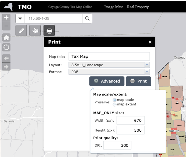

I want to disable select advanced options in the Print widget. I've found that scales aren't accurate when printing so I'm using a local print service with no scale bar or legend. I have been able to get the configuration of advanced options the way I want it in WAB 2.8 dev by commenting out some lines in widgets\Print\templates\Print.html. Now I'm trying to bring the same app into WAB 2.11 but this version has WKID and Feature attribute options which I can't seem to get rid of without breaking the functionality of the Print widget overall. This is what I want the options to look like:

Just wrap the elements that you do not want to see in a new div with a style of display none.
... <SPAN class="token tag"><SPAN class="token tag"><SPAN class="punctuation token"></</SPAN>div</SPAN><SPAN class="punctuation token">></SPAN></SPAN> <SPAN class="token tag"><SPAN class="token tag"><SPAN class="punctuation token"><</SPAN>div</SPAN><SPAN class="style-attr language-css token"><SPAN class="attr-name token"> <SPAN class="attr-name token">style</SPAN></SPAN><SPAN class="punctuation token">="</SPAN><SPAN class="attr-value token"><SPAN class="property token">display</SPAN><SPAN class="punctuation token">:</SPAN>none<SPAN class="punctuation token">;</SPAN></SPAN><SPAN class="punctuation token">"</SPAN></SPAN><SPAN class="punctuation token">></SPAN></SPAN> <SPAN class="token tag"><SPAN class="token tag"><SPAN class="punctuation token"><</SPAN>div</SPAN><SPAN class="style-attr language-css token"><SPAN class="attr-name token"> <SPAN class="attr-name token">style</SPAN></SPAN><SPAN class="punctuation token">="</SPAN><SPAN class="attr-value token"><SPAN class="property token">font-weight</SPAN><SPAN class="punctuation token">:</SPAN>bold<SPAN class="punctuation token">;</SPAN> <SPAN class="property token">margin-bottom</SPAN><SPAN class="punctuation token">:</SPAN> 5px</SPAN><SPAN class="punctuation token">"</SPAN></SPAN><SPAN class="punctuation token">></SPAN></SPAN> <SPAN class="token tag"><SPAN class="token tag"><SPAN class="punctuation token"><</SPAN>span</SPAN><SPAN class="punctuation token">></SPAN></SPAN>${nls.outputSR}<SPAN class="token tag"><SPAN class="token tag"><SPAN class="punctuation token"></</SPAN>span</SPAN><SPAN class="punctuation token">></SPAN></SPAN> <SPAN class="token tag"><SPAN class="token tag"><SPAN class="punctuation token"><</SPAN>a</SPAN> <SPAN class="attr-name token">href</SPAN><SPAN class="attr-value token"><SPAN class="punctuation token">=</SPAN><SPAN class="punctuation token">"</SPAN>https://developers.arcgis.com/javascript/jshelp/ref_coordsystems.html<SPAN class="punctuation token">"</SPAN></SPAN> <SPAN class="attr-name token">target</SPAN><SPAN class="attr-value token"><SPAN class="punctuation token">=</SPAN><SPAN class="punctuation token">"</SPAN>blank<SPAN class="punctuation token">"</SPAN></SPAN><SPAN class="punctuation token">></SPAN></SPAN>WKID<SPAN class="token tag"><SPAN class="token tag"><SPAN class="punctuation token"></</SPAN>a</SPAN><SPAN class="punctuation token">></SPAN></SPAN> <SPAN class="token tag"><SPAN class="token tag"><SPAN class="punctuation token"><</SPAN>span</SPAN><SPAN class="punctuation token">></SPAN></SPAN>:<SPAN class="token tag"><SPAN class="token tag"><SPAN class="punctuation token"></</SPAN>span</SPAN><SPAN class="punctuation token">></SPAN></SPAN> <SPAN class="token tag"><SPAN class="token tag"><SPAN class="punctuation token"></</SPAN>div</SPAN><SPAN class="punctuation token">></SPAN></SPAN> <SPAN class="token tag"><SPAN class="token tag"><SPAN class="punctuation token"><</SPAN>div</SPAN><SPAN class="style-attr language-css token"><SPAN class="attr-name token"> <SPAN class="attr-name token">style</SPAN></SPAN><SPAN class="punctuation token">="</SPAN><SPAN class="attr-value token"><SPAN class="property token">margin-bottom</SPAN><SPAN class="punctuation token">:</SPAN> 5px</SPAN><SPAN class="punctuation token">"</SPAN></SPAN><SPAN class="punctuation token">></SPAN></SPAN> <SPAN class="token tag"><SPAN class="token tag"><SPAN class="punctuation token"><</SPAN>div</SPAN><SPAN class="punctuation token">></SPAN></SPAN> <SPAN class="token tag"><SPAN class="token tag"><SPAN class="punctuation token"><</SPAN>input</SPAN> <SPAN class="attr-name token">type</SPAN><SPAN class="attr-value token"><SPAN class="punctuation token">=</SPAN><SPAN class="punctuation token">"</SPAN>text<SPAN class="punctuation token">"</SPAN></SPAN> <SPAN class="attr-name token">data-dojo-type</SPAN><SPAN class="attr-value token"><SPAN class="punctuation token">=</SPAN><SPAN class="punctuation token">"</SPAN>dijit/form/ValidationTextBox<SPAN class="punctuation token">"</SPAN></SPAN> <SPAN class="attr-name token">data-dojo-attach-event</SPAN><SPAN class="attr-value token"><SPAN class="punctuation token">=</SPAN><SPAN class="punctuation token">"</SPAN>onChange:_onOutputSRChange<SPAN class="punctuation token">"</SPAN></SPAN> <SPAN class="attr-name token">data-dojo-attach-point</SPAN><SPAN class="attr-value token"><SPAN class="punctuation token">=</SPAN><SPAN class="punctuation token">"</SPAN>wkidInput<SPAN class="punctuation token">"</SPAN></SPAN> <SPAN class="attr-name token">data-dojo-props</SPAN><SPAN class="attr-value token"><SPAN class="punctuation token">=</SPAN><SPAN class="punctuation token">'</SPAN>style:{width:<SPAN class="punctuation token">"</SPAN>100%<SPAN class="punctuation token">"</SPAN>}<SPAN class="punctuation token">'</SPAN></SPAN> <SPAN class="attr-name token">data-dojo-props</SPAN><SPAN class="attr-value token"><SPAN class="punctuation token">=</SPAN><SPAN class="punctuation token">"</SPAN>required: false<SPAN class="punctuation token">"</SPAN></SPAN><SPAN class="punctuation token">/></SPAN></SPAN> <SPAN class="token tag"><SPAN class="token tag"><SPAN class="punctuation token"></</SPAN>div</SPAN><SPAN class="punctuation token">></SPAN></SPAN> <SPAN class="token tag"><SPAN class="token tag"><SPAN class="punctuation token"><</SPAN>div</SPAN> <SPAN class="attr-name token">class</SPAN><SPAN class="attr-value token"><SPAN class="punctuation token">=</SPAN><SPAN class="punctuation token">"</SPAN>wkid-label jimu-ellipsis<SPAN class="punctuation token">"</SPAN></SPAN> <SPAN class="attr-name token">data-dojo-attach-point</SPAN><SPAN class="attr-value token"><SPAN class="punctuation token">=</SPAN><SPAN class="punctuation token">"</SPAN>wkidLabel<SPAN class="punctuation token">"</SPAN></SPAN><SPAN class="punctuation token">></SPAN></SPAN> <SPAN class="token tag"><SPAN class="token tag"><SPAN class="punctuation token"></</SPAN>div</SPAN><SPAN class="punctuation token">></SPAN></SPAN> <SPAN class="token tag"><SPAN class="token tag"><SPAN class="punctuation token"></</SPAN>div</SPAN><SPAN class="punctuation token">></SPAN></SPAN> <SPAN class="token tag"><SPAN class="token tag"><SPAN class="punctuation token"></</SPAN>div</SPAN><SPAN class="punctuation token">></SPAN></SPAN> <SPAN class="token tag"><SPAN class="token tag"><SPAN class="punctuation token"><</SPAN>div</SPAN><SPAN class="style-attr language-css token"><SPAN class="attr-name token"> <SPAN class="attr-name token">style</SPAN></SPAN><SPAN class="punctuation token">="</SPAN><SPAN class="attr-value token"><SPAN class="property token">font-weight</SPAN><SPAN class="punctuation token">:</SPAN>bold<SPAN class="punctuation token">;</SPAN></SPAN><SPAN class="punctuation token">"</SPAN></SPAN> <SPAN class="attr-name token">data-dojo-attach-point</SPAN><SPAN class="attr-value token"><SPAN class="punctuation token">=</SPAN><SPAN class="punctuation token">"</SPAN>labelsTitleNode<SPAN class="punctuation token">"</SPAN></SPAN><SPAN class="punctuation token">></SPAN></SPAN> ${nls.labels}: <SPAN class="token tag"><SPAN class="token tag"><SPAN class="punctuation token"></</SPAN>div</SPAN><SPAN class="punctuation token">></SPAN></SPAN> ...<SPAN class="line-numbers-rows"><SPAN></SPAN><SPAN></SPAN><SPAN></SPAN><SPAN></SPAN><SPAN></SPAN><SPAN></SPAN><SPAN></SPAN><SPAN></SPAN><SPAN></SPAN><SPAN></SPAN><SPAN></SPAN><SPAN></SPAN><SPAN></SPAN><SPAN></SPAN><SPAN></SPAN><SPAN></SPAN><SPAN></SPAN><SPAN></SPAN><SPAN></SPAN><SPAN></SPAN><SPAN></SPAN><SPAN></SPAN></SPAN>
Lines 3 and 18 above were added.
Thanks! I don't do a lot of coding, but I will definitely use this here and in the future.
