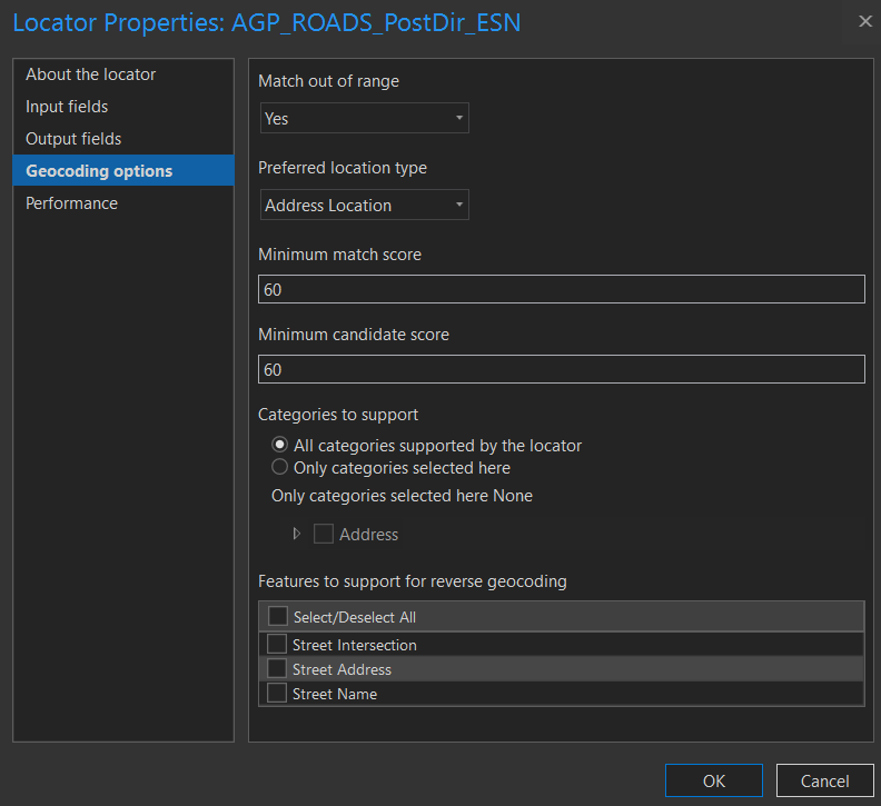

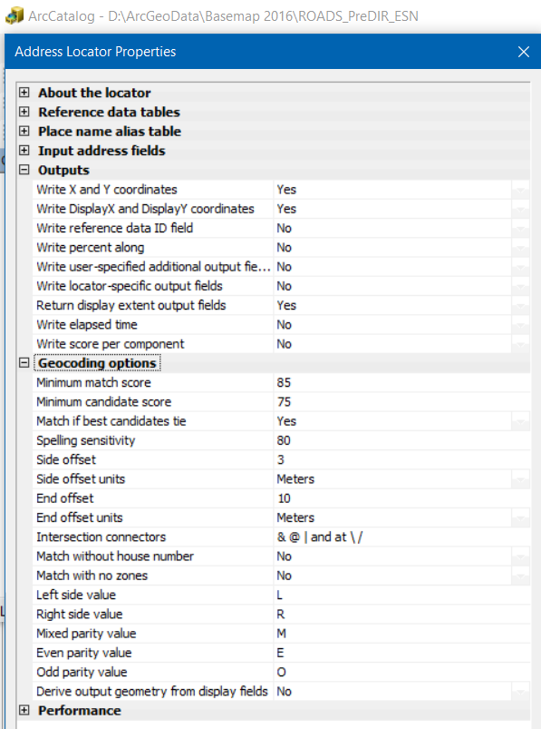

While working to improve our locators, moving from AM to AGP locators, we have noticed that the abundance of options found in AM are no longer available in AGP (see pics below as just a few options no longer available), or we are just missing where to set these options. We have found that catering these settings have been a tremendous benefit when customizing locators for specific needs. However, due to “optimization” of the locators within AGP, nearly every setting possible within the AM Locators are gone. For example, when checking in with ESRI regarding the ability to set the Side Offset within the locator properties, it was that dreaded statement we end users hate to hear, “We’ve optimized the new locators and the default offset is 3m and there is no option to adjust the side offset. This setting will not be in the next release. I would encourage you to submit an enhancement request including a justification for the need or perhaps adding as an idea on GeoNet.” If it’s not broken, why fix it? We loved having the settings offered in AM and would love for ESRI to consider some of the major settings used by the end user to be returned to the locator property window. Thank you ESRI.
