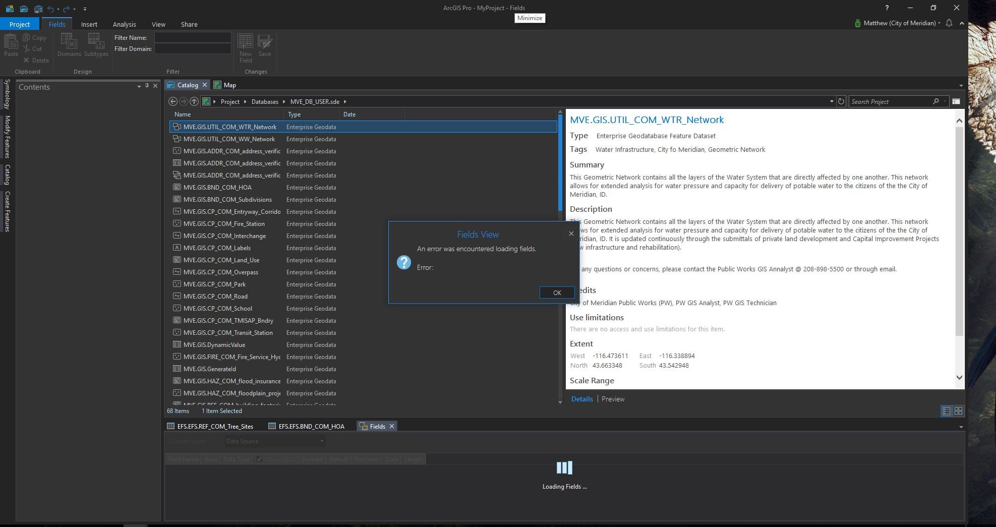

I have the latest version of ArcGIS Pro 2.1.1. When utilizing 2.1 I could view the fields tab. With the latest version that is now delivers an unknown error with no explanation. I am currently going to uninstall 2.1.1 and roll back to 2.1 and see if it works again. Does anyone else have an issue with this?
I just upgraded to 2.1.1 as well, and have no trouble opening the fields tab (right click / Design / Fields) for an ordinary Feature Class stored in a File Geodatabase.
However, I noticed you are attempting to open the fields tab for a Geometric Network. What happens if you select an ordinary Feature Class?
Same as Marco... no SDE, just File Geodatabases stored locally... hopefully narrowing down the field of issues
It isn't entirely clear what exactly you're clicking on... in Catalog View, you have a Feature Dataset selected. There is no Design > Fields option from the right-click context menu for a Feature Dataset.
Can you provide repeatable steps to generate the error?
Thanks!
So here after some testing here is what I found. The Table to Domain tool in ArcGIS Catalog can corrupt the created domain during its construction thus causing the error in the fields tab. I had to hand build the domain from the table and this allowed the fields tab to work. I have let a solutions engineer at ESRI know about this issue.
