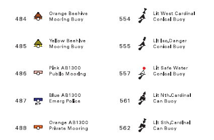

For ArcMap we use a style sheet which in turn uses emf files to draw point symbols. A subset is shown below. Is there a way to create custom marker points in ArcGIS Pro? We have over 300 different point features so I prefer not to use the 'Picture Marker' option. Also this option imports the point symbol as a raster and loses resolution. I prefer to maintain each symbol as a vector which maintains high quality symbols.

While simple symbols can be created in ArcGIS Pro by using layering with basic shapes, I use a graphic software to create complex symbols, export then import into ArcGIS Pro.
