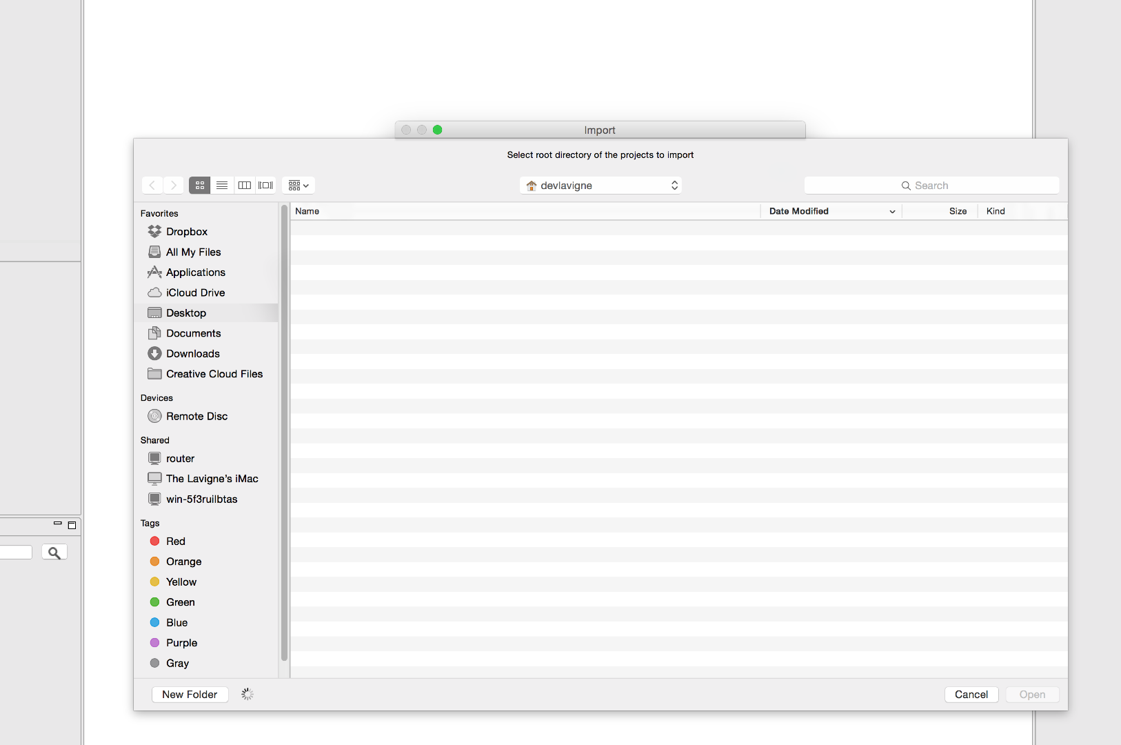

I've recently installed 2014.1 on my Mac running Yosemite and now I cannot browse any directories on my computer from within CityEngine - so its impossible to Switch/Create Workspaces or Import projects or files into a project or workspace. Has anyone experienced this? - All i see is a spinning wheel in the bottom left.

hi
this is a known issue without any currently known workarounds (let us know!). CityEngine 2014.1 (and older) does not support OSX 10.9 or 10.10. at this moment we only support OSX 10.7 and 10.8. we recognize that 10.7 and 10.8 are fast getting out-of-date and plan to support 10.9 and 10.10 for CityEngine 2015.0.
kind regards,
the CityEngine dev team
