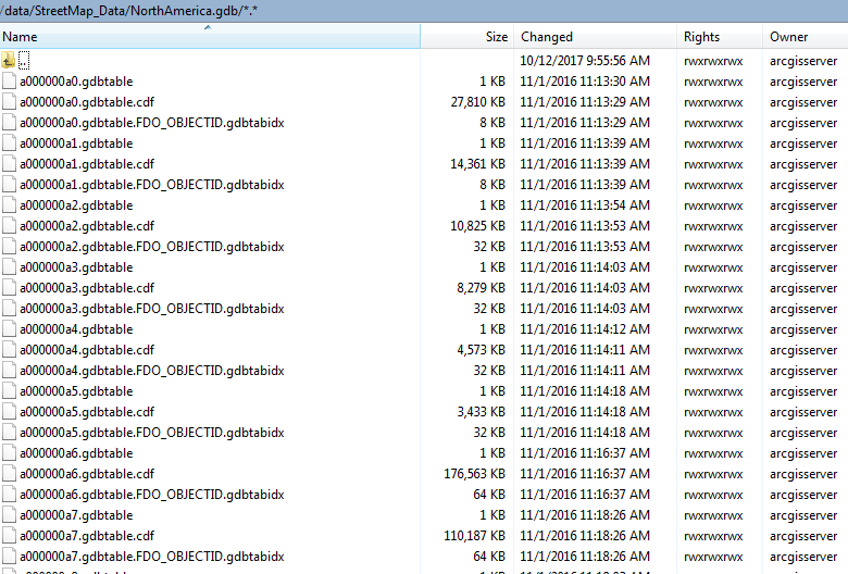

2. The ArcGIS Server Account is the owner of the data, and has 777 permission to the data.

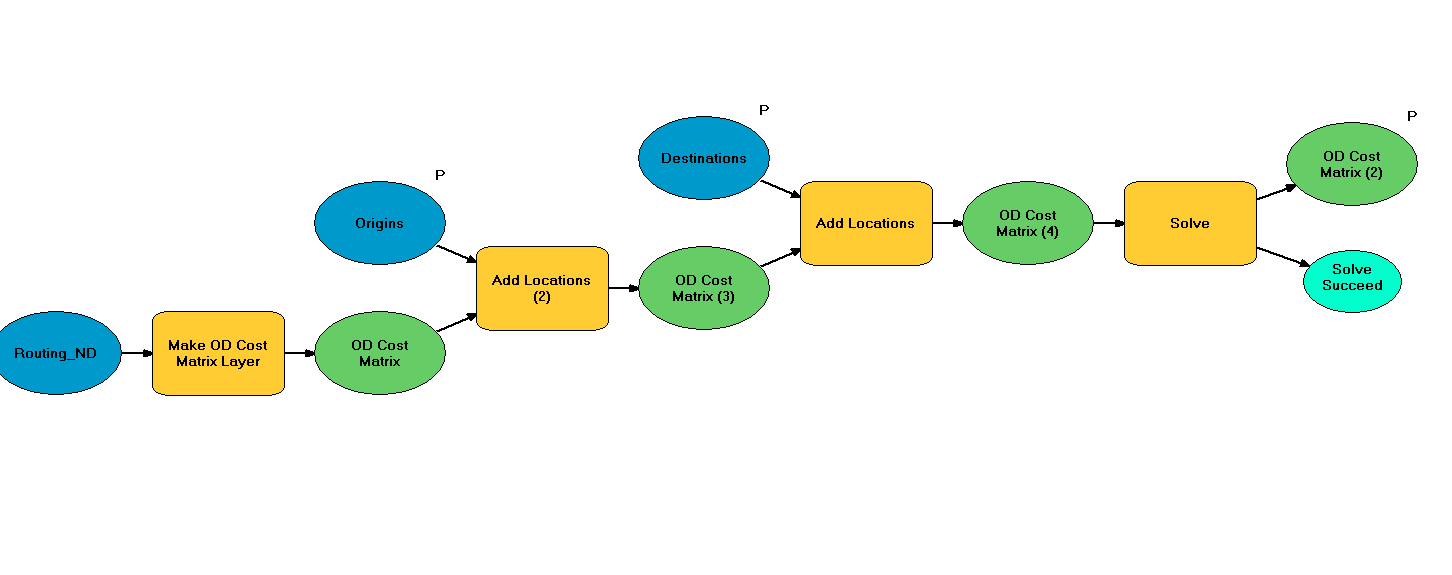

I created this model to solve OD Cost Matrix, and published it to ArcGIS Server.
The data was registered with ArcGIS Server,
Permission in Linux machine

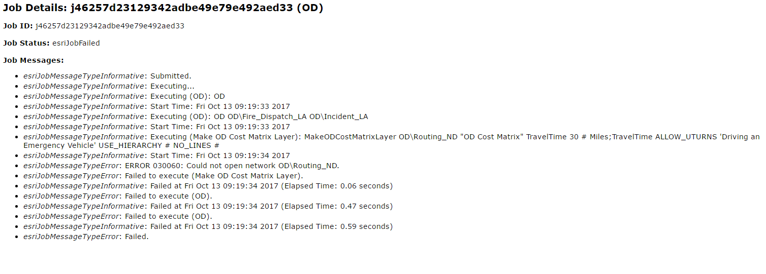

It failed with this GP job message,
