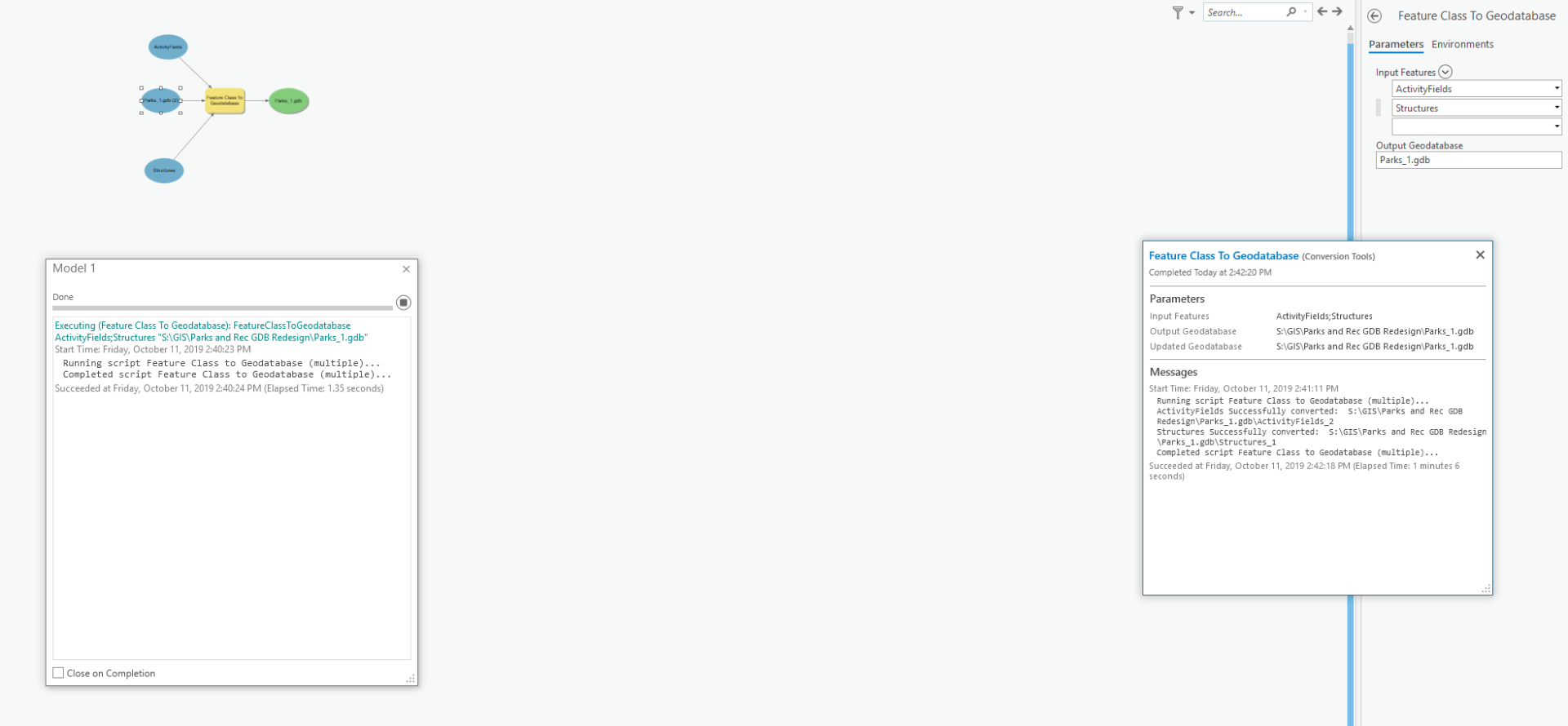

I am trying to take a number of feature classes I have in AGO and move them to an on base database. When i use the geoprocessing tool this works fine as shown on the right. But if i attempt to drag and drop that geoprocessing tool into model builder and run it that way it runs instantaneously because its not converting the layers. I have the layers from AGO in my map contents and i'm using the same drop down choices. What gives?
it appears i was missing an update and now it works.

I gave this a quick test, and it is working for me in ModelBuilder. I did run into some iteration-related errors when I ran the model multiple times, but I am not seeing those in your included screen shot. Are the layers you are using as inputs coming from the same Hosted Feature Service or a different Hosted Feature Service? What version of ArcGIS Pro are you working with?

Separate feature services. And version 2.4
