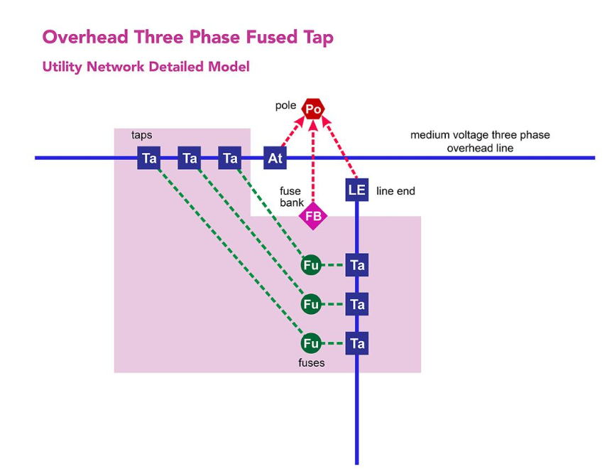

Hi there,Is there any documentation/models on the fundamentals? I’m struggling to see these.The models at the moment I’m looking for relate to
Taps - Is a tap required per phase/neutral or a single tap with a phase attribute. Having a tap per phase seems a bit excessive and it clutters the network. As described in the story map image, the line is a 3ph line. Why is there a need for 3 taps? If only for the 3 individual fuses these could be modelled as a single object with attributes to indicate 3ph.

Another example that needs clarity. What is the need for individual taps for a 3ph to 3ph connection? Could this be solved with a single tap?

Hi Damien,
This is a high fidelity phased circuit representation. That's why 3 individual taps are used. You can use a single (3 phase) tap, but you need to reconfigure the subnetwork definition, propagator and attribute substitution accordingly.
Propagators are available through python, model builder or via C# SDK.

Hi Damien.
The UN and the model we have provided support multiple levels of detail. The diagrams we have provided thus far, so the maximum detail. We are working to document multiple levels of detail and the benefits of each level. Let's take the Tap example. If you are using esri's Electric Foundation model, no reconfiguration is required to replace the Three Single Phase Taps with a Single Tap. It all just works out of the box. Also, you can use a mix of Single Phase Taps and Three Phase taps, no configuration modifications required.
