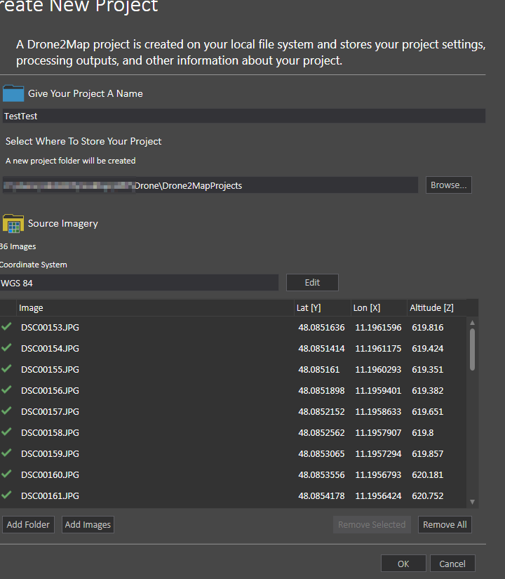

Using the ESRI supplied imagery sample >> Launch Drone2Map >> Create new 2D Project.
Add the folder that contains the images..
Press OK
And NOTHING shows up:

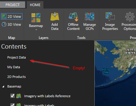

If anyone comes across the one issue of 'nothing' being visible in Project Data (Flight Path and Images - points) then..
it is due to having HTTPS only enabled in the portal / AGOL. This must not be checked (enabled).
As far as the crash and not being able to process ... is still an ongoing battle.
Yes Drone2Map 1.01 doesn't not load correctly when the Organization is set to HTTPS only, this has been fixed in Version 1.1
