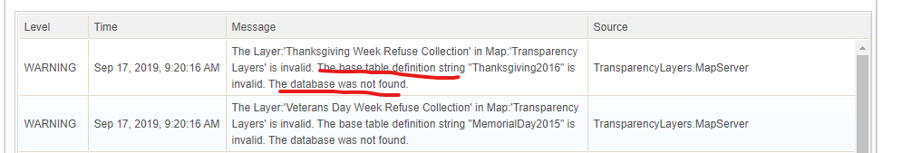

I have recently been getting an error when I changed some layers in a map service. The layers are shapefiles and are not registered with the server at this time. I am ok with them being copied to the server but it appears they are not actually being copied when being published. The other layers that are registered in this map service are being published just fine. I checked the logs and found this error which doesn't make any sense to me because no errors show up when trying to overwrite the service. The only issue is that the data is not registered and must be copied to the server. These are small shapefiles so this shouldn't be an issue for publishing.

I found these that reference the error you are seeing:
Error: The base table definition string "[STRING]" is invalid
Looks like it may be a folder permissions thing with the account that is running the ArcGIS Server Windows service.
https://community.esri.com/thread/58748
Looks like it was a similar issue for this other user as well.

UPDATE: Giving the user arcgis full permissions did not fix the problem. That particular user did not have full permission before.
I believe it. Although, I don't understand how my permissions changed because what I did was replace another layer that was in the same folder and didn't present the same issues.
