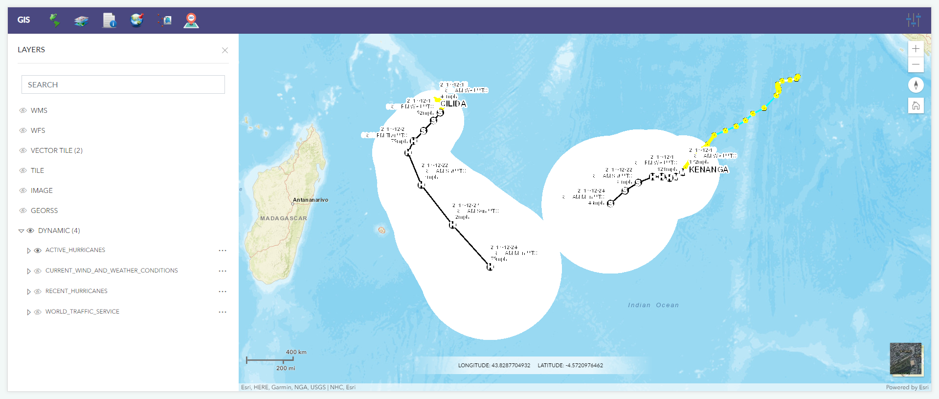

After updating to version 4.10 a vector tile layer is not rendering correctly but working perfectly fine in version 4.8. Does anyone encountered this kind of problem? I there any solution/workaround for this? Hope anyone could help me on this.

Here is the URL of the Vector Tile https://www.arcgis.com/sharing/rest/content/items/75f4dfdff19e445395653121a95a85db/resources/styles/root.json?f=pjson. And for the image map layer https://livefeeds.arcgis.com/arcgis/rest/services/LiveFeeds/Hurricane_Active/MapServer from the screenshot.

Thank you for your reply. The problem is the opacity. I removed the opacity and now it's working perfectly.
