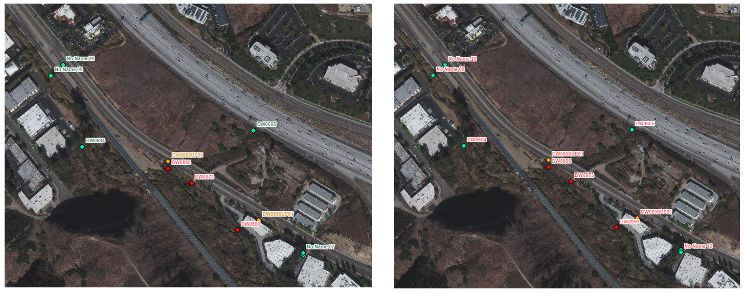

Is it possible to have the hosted feature layer view inherit the label styles from the hosted feature layer (parent layer)? The parent layer with label classes was published from ArcGIS Pro. There are three label classes, one for each symbol class in the hosted feature layer, so I would like to retain those labels in the hosted feature layer view. I have to create new labels for the hosted feature layer view when adding it to a map, but AGOL is limited to only one style option. I have attached screenshots - left image is the hosted feature layer, right image is the view layer. Thanks.

Thank you for presenting this interesting scenario. I don't think this is possible through the ArcGIS Online UI (at least I'm not seeing where you might accomplish this), but you can accomplish this through some clever use of the ArcGIS API for Python.
You mentioned your current workflow is to publish from ArcGIS Pro and then create the view in ArcGIS Online. That is a key detail: this means that the labeling information of the original service is stored within the service definition itself and not at the item level. Indeed, if you create a view from the original service, you can even see that the same exact labeling properties are defined. The problem, however, is for some reason they are not exposed. The good news is, you can expose those dormant properties by modifying the item after the fact.

Thank you Earl for the detailed explanation and workaround for this scenario. I am a novice with ArcGIS API Python, so this will take me a little time to learn and process. Out of curiosity, why do label classes publish to AGOL for some layers but not for others? I have other hosted features that I created in a similar fashion, but the label classes did not transfer.
My apologies for the delay. I'm glad the information was helpful! I am not sure about label classes and would have to test that out. Perhaps there is a limitation for label classes someone else can expand on?
